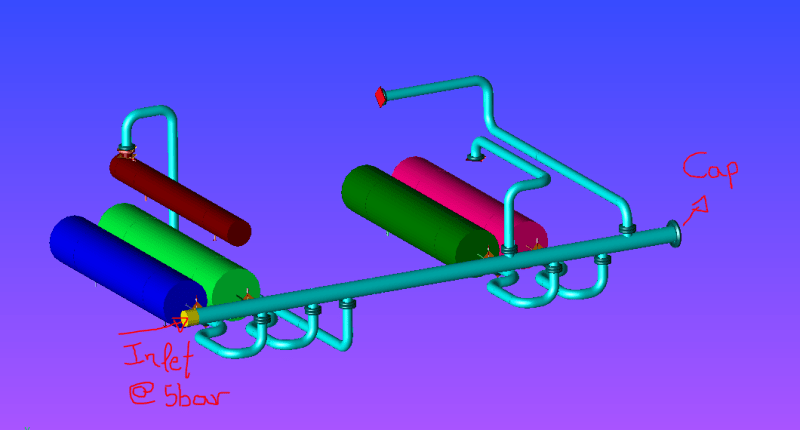

Hello to all,
I need your insight regarding the procedure I should follow in order to size a Cooling Water Supply and a Cooling Return Manifold.
The Supply manifold feeds water to 6 Coolers, all located very close to one another. The Vendor of the Coolers has given info regarding how much water is needed (mass flow rate) for the cooling process.

So for each branch that connects the manifold to the respective cooler I have calculated the Volume flow rate (Q1,Q2...,Q6), and considered a maximum velocity of v=2m/s for each branch, in order to calculate their Size.
Considering Qi = v*Ai => Ai = Qi/v
Ai = pi*Di^2/4 => Di = sqrt(4*Qi/v*pi)
The sizes that I have calculated are:
Branch 1: 16"
Branch 2-5: 10"
Branch 6: 20"
Considering all these: please give me feedback regarding the procedure I have followed to Size the branches and considering those sizes are correct, how do I size the CW Header?

Needs a diagram, so e.g. where does the incoming water enter the header?
on the end? both ends? in the middle? two connections? Makes a big difference as does where in the sequence these offtakes are.
Worst case is in at one end.
Normally a good ROT is to sum the outlet headers square area and use the square root of that as the header size.
So in this case a 36" header. Sounds reasonable to me when you've got a 20" connection flowing at 2 m/s at the same time as 4 10" and a 16".

Thank you all for the prompt replies,
The manifold will be about 25m in length, the flow comes from the one side at pressure of 5 bar and the other side has a cap. In the photo below you can see a preliminary arrangement just to get a feeling of what we are talking about. Thank you again [bigsmile]
In at one end is the worst case so I would go for min 30" fixed diameter.
You could get fancy and have 36" or 30" for the first 3 then reduce down to 30" or 24", but frankly just not worth it.
Why are some off the top and others off the bottom? Should all be the same to avoid any issues with air.
Where is #1 and especially #6 ?
Those 2 carry more than 2X the sum of the others.
Such Long headers are usually fed at the middle.
End feed potentially forces you to consider and avoid maximum velocities.
If those both are near the cap, a 30" might work.
If those are both at the source, 24" may be possible and too big for the rest of the 25m length.
If feed was from center, a 24" could be a reasonable choice.
CW header size will depend on which set of these coolers results in max flow in this header - are all coolers running at max flow all the time ?
The sizes you've computed for each branch seem reasonable at 6fps. For these short branches, you could use up to 10fps, provided these are not copper nickel pipes.
Center feed does tend to minimize velocities, as it can split total flow in half immediately. It should usually be your first instinct to finding a configuration that works as well as possible. Here maybe not so much, because you have a wide variation of chiller sizes. Here maybe you need to offset the feed from center to try to balance flows to get half going to each side. Depends on your order of chiller branch lines. Or just change the branch line configurations and header connection order to get a more balanced flow. Providing it doesn't look like a plate of spaghetti when it's finished.
