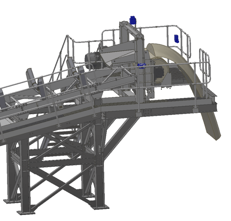

Hi everyone,
It is my first post here. I've been lurking around and reading answers to questions I've for a while now. I've just graduated last year and I'm in my training period. I still have a lot to learn and a lot of questions I need answers to. And for a fact I know there are lots of experienced and knowledgable people to answer my questions. Pardon me for my english as well, as it is not my first language.

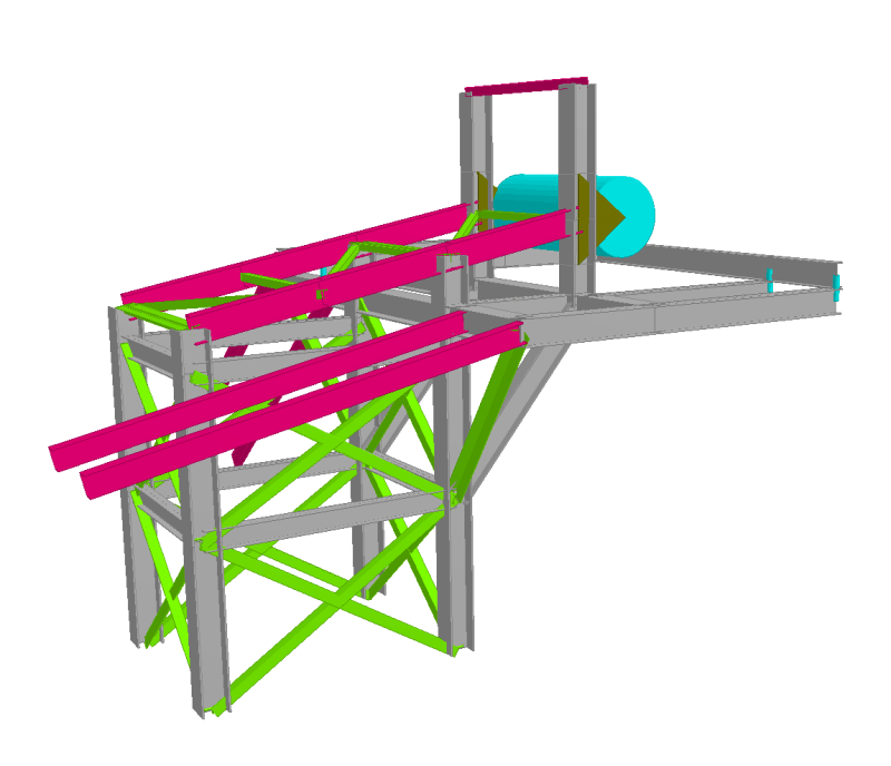

So back to the question, I've a connection design to verify against Eurocode(or British Standards) as shown in the attached picture. The end force I've gathered from STAAD is 106kN in Compression, 13.4 +Vshear and 11.3kN +Mz. For verification of axial force, is it just a matter of resolving the force and use same method as you would for a moment connection? If so, What about moment verification?
Are there any good books or tutorial for verification of connections using Eurocode?

It's hard to say without seeing more of the model (especially how the forces are applied at nodes 66 & 67, and how those diagonal braces are supported at those nodes).
By the way, do you have an offset where those diagonals frame into the columns? Just eyeballing your pic from STAAD.....I don't see it.
[red]EDIT[/red]: By the way, looking at your pic....if you are intending the diagonal connection to be fixed (in either the strong axis or the weak axis), you are missing 2 bolts below the lower flange.
I'd expect something closer to 70 kN for the shear in the joint.
Not in STAAD analysis I've modeled. Inventor model wasn't done by me and I need to check back if their centreline meet each other. But by looking at it, it seems so? These connections were done by draftsmen and I am here to check and change to whatever it is necessary.

I think what he means was to resolve the axial load into compression and shear going to the column using triangle of force? That's what I have done for now. Got around 70kN of shear like @KookK suggested. And I need to check my column web for buckling from compression after that I assume. What I am unsure right now is to whether I could just use M/depth to get tension and compression in upper and lower flange? Because that's what I usually do but this time around the beam is at an angle. Not really sure if I would be able to use the same method.
I'm not sure what you mean, but that diagonal brace needs an offset going into that column.
Sorry, but Could you care explaining why I need an offset on the diagonal beam?
[blue](Accumulated)[/blue]
It adds moment that the column will see. The offset I refer to is where it frames into the column.

Whether or not you need an offset depends on how you detail the connection and where your workpoint is. Conventionally you don't add offsets to braces and resolve the moment into the gusset, or in this case it is capture by additional moment in the brace. You just need to detail the connection so that this behavior is possible. Looking at the structure I don't understand why you need a moment connection for the diagonal - if you want the simplest possible solution, model the diagonal as a truss and offset it from the column (and beam above) per WARose's suggestion, and design the connection for shear and axial.
I might just do that. Give it a full depth end plate connection and design only for axial and shear.
I second canwesteng's suggestion. That's exactly what I would do unless there was a compelling reason to do otherwise.
Are all your connections moment connections? The model looks like it might be that way.
Keep moment connections to an absolute minimum. Start with pinned connections and proceed from there.
