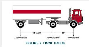

When it comes to traffic loads I found the best approach is to be specific. If you are check for a specific loading then state it, check for that, and state it is good for that load. Sounds like you are checking a HS20.

You may want to look up the loading for an HS40 truck, or whatever the current vehicle is, or whatever the max vehicle you will have is... Using an average load based on the footprint does not even closely mimic your SOG. Also take a gander at:
I agree with GC_Hopi that communication is the key. The engineering is fairly straightforward: 15-20 tonne axle and 1200-2500 psf distributed, depending on ground stiffness & concrete grade, and assuming the ground can take it. This assumes load transfer at joints or sufficient edge thickening.
But, tyre contact pressure is more like 15,000 psf so people might freak out if you tell them 1,500 psf. Send them a picture like GC_Hopi's.
