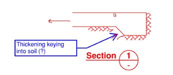

For slab on ground illustration below, edge thickenings will partially(?) restraint slab shrinkage in X-direction (assume thickening is 1.5x slab thickness & sloped at 1:1). I suppose it won't be fully restrained as it isn't fixed or anchored to any type of footing, but it still providing some degree of restraint.
ACI 360R-10 Guide to Design Slab-on-Ground says that with 1:10 gradual slope and low friction of subgrade, shrinkage restraint effect shouldn't be a concern (considered no restraint at all). AS3600 & CCAA T48 don't cover this issue at all.
Any solid reference on shrinkage rebar design based on partial(?) restraint of edge thickening?
Much appreciated.
