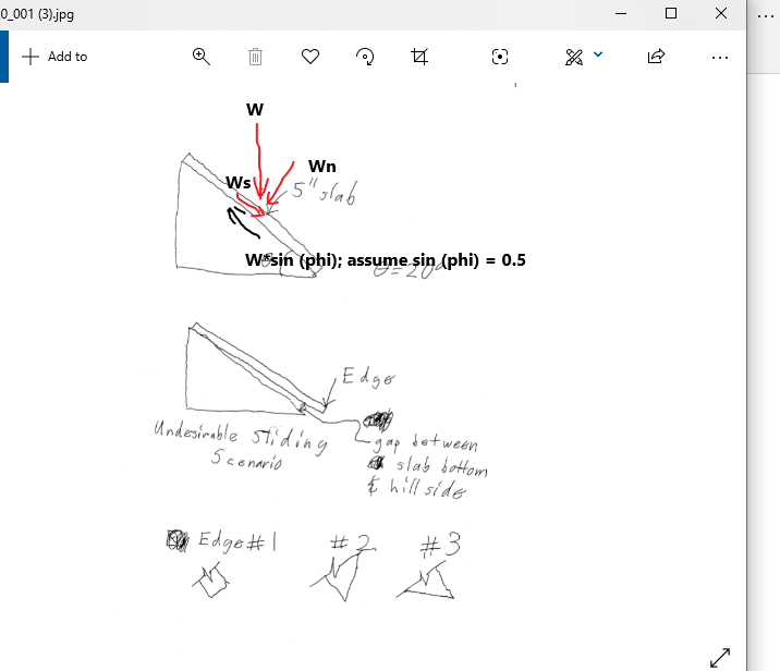

This is a home/property project.....but I need ideas. I am thinking about pouring a slab on a slope. (See attached pic. Sorry if it looks sloppy to you.) The thing that worries me is: this is likely susceptible to a sliding failure because of the slope. (Needless to say, I haven't called a geotech on this. So I don't know what the coefficient of friction is. The numbers I've come out with put the SF at about "1")
I could live with the sliding down.....but, I really don't want the "undesirable" scenario (shown in the pic) to happen. So my question is: would having one of the edges (3 options shown) possibly insure the slab penetrates the soil at the bottom to prevent the "undesirable" scenario?
Before anyone asks: right now, changing the slope is not a option. Anchoring the slab (into the slope) is something I've considered......but right now, I'd like to focus on: what happens if it does slide down and can I control that? Thanks.

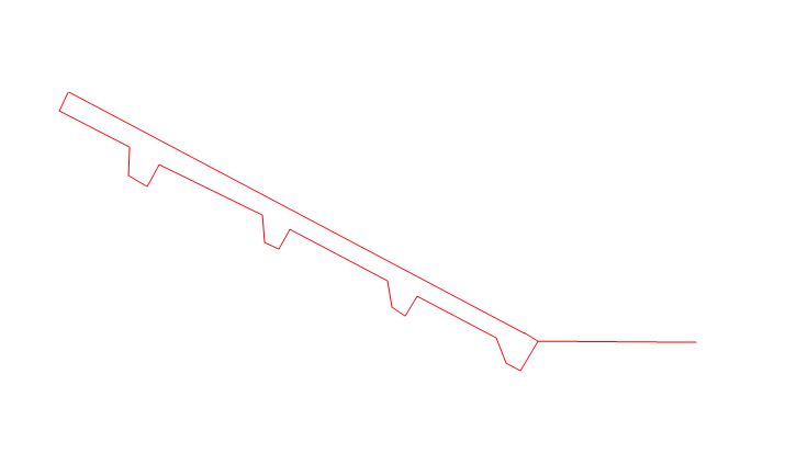

Second - could you add some under-side keys to create a "grab" of the slab to the soil?
The idea is to engage some passive resistance along the slab length?
To address the potential for sliding, you might consider thickening the bottom edge of the slab such that its embedded some distance in the soil (like a shear key) JAE beat me to it
I've thought about that.....but it would make forming a whole lot more difficult......QC on this job isn't going to be that great either. (Since it's me and a bucket.)
Well not really forming - just trenching the grade below the slab with cross trenches. Not a whole lot of cost there.
Or build a large key grade beam at the bottom but I like the multiple key idea better.
I'll give it some thought.....but I normally like some rebar in the key. That adds to the difficulty of it.
Not sure what the anchor bars below are...perhaps into rock or something.
I would do what you mentioned - series of vertical bars in the keys to take the key bending.
If Wconc*sin θ > 0.5*Wconc*cos θ, sliding will occur, then you need to provide a resistant force equal to, or greater than the difference. Shouldn't be large, for such mild slope.
Forgot to mention safety factor for potential to lose friction if the subgrade getting wet. One experimental method is to embed short PVC pipes into the subgrade, grout them full, then cast with the pavement. The effect is the same as a key way, should work for residential small project.
Provide the downturn thickened edge at the base. Extend your rebar into the thickened edge. I would much rather rely on soil bearing at the base than friction along the full height.I would not even consider the mid height intermediate thickened keyways as this is unnecessary material that would slow down your pour rate (especially if you are hand mixing everything).

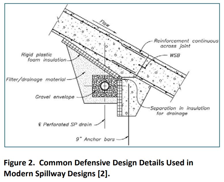

In another note, I think, depends on detail "B", SRE provided an excellent example/solution.
SRA's solution is very good. According to MK Hurd's "Formwork for Construction", 1H:1V slopes need a top form. There is a footnote in the text from ACI Committee 347 on formwork, that indicates that top forms should be placed on slopes over 12H:8V, but for lower slopes a low slump concrete is required and rebar helps too. Your sketch indicates 20degrees but arcsin(0.50) = 30 degrees instead. If it is 30degrees then depending on the soil properties you may have to investigate slope stability issues too and slab undermining from erosion. JAE's is interesting with the bottom drainage considered. His previous local thickening of the slab may cause some cracking since it is a slab stress raiser. I hope this is helpful, I enjoyed your previous posts over the years.
