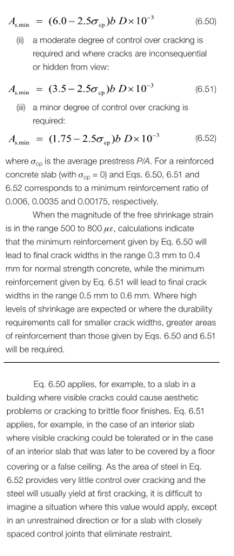

Section 9.5.3 answers your first question. Why is there any doubt about that bit?

What’s the basis for 0.6% strong crack control? Is there marginal benefit beyond that? I’ve seen some designs for continuous concrete pavements with greater than 1%, which has always made me wonder if 0.6% is really all that much.
It's lots... 3x normal temperature reinforcing... still get the shrinkage cracking but it's more dispersed and finer...
Tomfh, this is from the Concrete Institute of Australia's document Z7/06. There's strong and then there's stronger.
Thanks steveh49.
Any idea why AS3600 doesn’t have “even stronger”?
Tom,
Because they are minimums. For any situation and specific level of restraint and crack control you require, you are supposed to calculate what is required for those conditions.
To achieve .2mm crack width with full restraint, you will probably require 1%.
It's also worth noting that the qualitative language of 'minor', 'moderate' and 'strong' rather than quantitative intervals reflects the uncertainty in the underlying theory.
