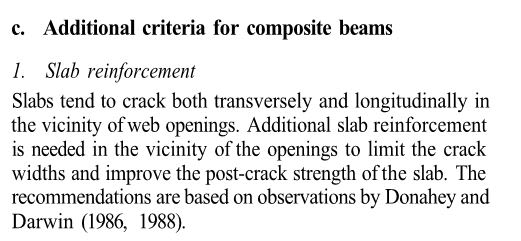

Later in the commentary they say this:
So I think the 0.0025 (wherever the number actually came from) is an effort to ensure that the concrete is "held together" and cracks are kept under control to ensure that the combined concrete-steel-web opening assembly works as intended. If the slab cracks open, or pieces spall away, the capacity (shear and flexure) at the location of the opening would be diminished.
