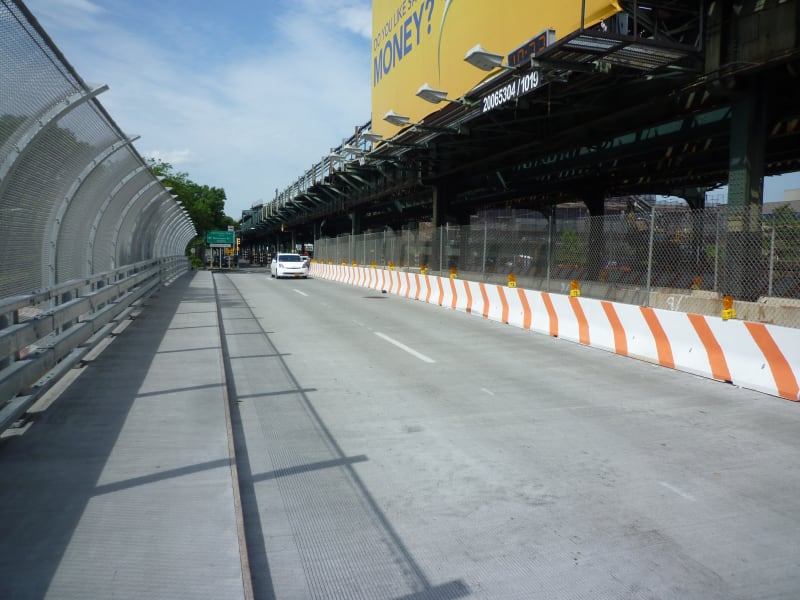

You're welcome dik. This is from a current project under construction. It has the regular traffic railing in front of the fancy fence.
looks attractive and no razerwire needed... again thanks BB. just thought... jumper resistant.
Fences on bridges over railroads have to be a minimum 8' high and curved or slanted in, or 10' high if they're straight. It's to try to prevent people from throwing things onto the trains.
Thanks, Rod...
In the past Amtrak used to require an 8' barrier over electrified rails. It was usually a 4' concrete with a 4' solid metal barrier on top. Now they require 6'-6" concrete barrier with a 3' fence. We had a project in NYC over Amtrak 2 years ago, the 6'-6" barrier caused the DOT some grief. This was an interstate bridge, which would use a crash tested 3'-6" barrier; the 6'-6" barrier wasn't crash tested. Between us and DOT we were able to prove that it would work; no crash test.
