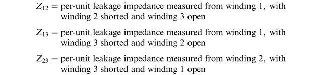

I am not sure if I have interpreted the FAT data of the Aux TF correctly but below is what I have come up with:
TF2 Zero sequence impedance is as follows:
Z12 = Zps = 125.8 ohms/phase
Z13 = Zpt = 141.1 ohms/phase
Z23 = Zst = 0.0097 ohms/phase
