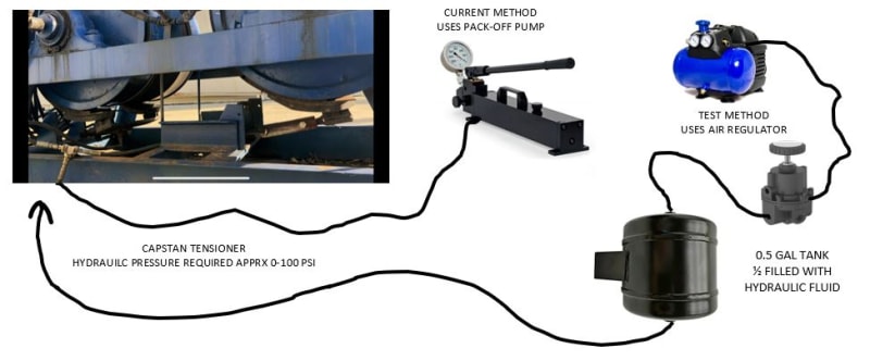

Thank you all for the replies. Forgive me as this is my first post... I do not see a way to reply to individual responses, only 'reply to the post'. Allow me to clarify my scenario:
We have trucks with 15K+ feet of wire spooled on for oil, gas, and geothermal well service work. Occasionally we spool new line [under tension] on the trucks. Our current method is open-loop: an operator has one hand on a pack- off pump which applies hydraulic pressure to a capstan brake [to vary the tension], and an eye on the line-tension display. If the line tension decreases, he pumps the pack-off pump to increase the drag at the capstan. If the tension increases, he bleeds off a little pressure to reduce the tension.
I want to automate this and make it closed-loop. I'll fabricate a portable box that we place at the truck when spooling new line. I'll use a 4-20mA output from the line-tension sensor on the truck and bring it into the 'box' as my feedback. A small display on 'the box' will allow the operator to enter the setpoint (desired tension). The 'box' will have small hydraulic pump, and a variable valve to control the pressure out to the brake on the capstan; I think this should keep the line tension fairly constant.
I know enough about controls to make it happen [in theory]... I just do not have the hydraulic experience to choose a valve.
Thanks again!

The attached image [below] shows the basics of the existing set up: the brakes on a capstan are currently being controlled with a hand pack-off pump; the greater the pressure on the brakes, the greater the capstan causes tension on the line being pulled around it. The hydraulic pressure required to obtain the tension I want is only on the order of 50-100 psi.
The second part of the image shows my proposed test. I bought a precision, relieving regulator (0-150psi) and 0.5 gal tank good for 200 psi. I'll fill the tank approx. half full of hydraulic fluid, then use the air regulator to vary the pressure over the hyd. fluid, which varies the brakes, which varies the tension on my line as I am spooling it onto the truck.
If this works well enough, I'll leave it with just the regulator [open loop]. If it really well and we want to go to the next level, I'll get a small PID controller and an Electronically Controlled Precision Compressed Air Regulator like this one from McMaster Carr and attempt to do it closed loop. (https://res.cloudinary.com/engineering-com/image/upload/v1671231877/tips/CAPSTAN_PRESSURE_DIAGRAM_smguim.jpg[/img]s/maximum-pressure~100-psi/regulator-style~relieving/]Link)
That should work. The reaction time might be a bit slower than the hydraulic oil version but that might be a good thing?
Let us know how it goes.
I thought you might need more than 100 psi but that's well within a simple air compressor range.
