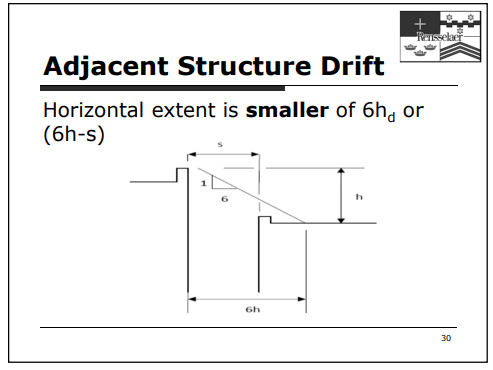

I have a design problem where a new decorative wall is being placed in front of an existing building.
To prevent snow from drifting on the existing roof, there was a thought about pulling the wall off and away from the existing building and providing a gap. But with only a 1' gap between the building and wall, I am concerned drifting could still occur.
Does anyone have any insight into this problem or know of any stipulations in ASCE 7-16 that address this issue. Does anyone know of any articles about this situation that they can recommend?
I have attached a rough sketch depicting the design problem. The building is located on Long Island NY with a Pg = 30psf the roof is flat.
Thanks,
John

The commentary to ASCE 7-16 mentions that when a new structure is built within 20 feet of an existing structure, drifting possibilities should be investigated. I would imagine a drift forming as if the gap is solid, then remove the snow directly above the gap. But in your case where there is only a one-foot gap I would assume that the snow does bridge over that gap, although the additional weight is small.
flight7,
Thank you for the information I will review the ASCE commentary. I agree with your thoughts on the gap being bridged.
For your condition you're obviously concerned about a windward drift. Without snow bridging that opening I doubt you'll see much of a drift. Under ideal conditions it's possible you could see a bridge there, but wouldn't be a common occurrence.
If you can move the sign a bit further away that would solve that problem. I'd think 3-4' would be enough of a gap to prevent any chance of bridging. Certainly wouldn't need to be 20'. I believe that 20' requirement applies to leeward drifting.

The 20' requirement seems to apply for both windward or leeward. However, my situation does not seem to be addressed.
Pulling it off the building a bit more may be the way to go to avoid drift.

a 1' gap would have little or no effect...
Dik, can you explain that a littler further?
JRR66,
Looks like this should help (image excerpted from p.15 of doc provided by HTURKAK).
