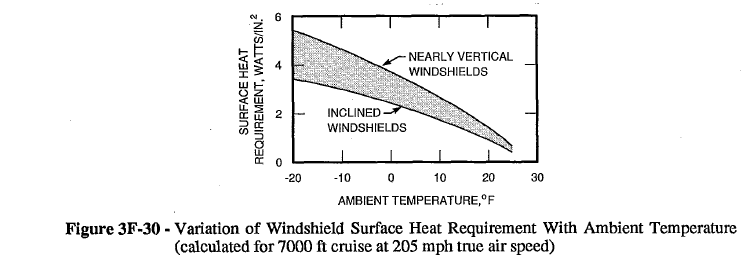

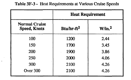

SAE AIR 1168-4 Ice, Rain, Fog, and Frost Protection is the ticket for you. While it's intended to address aircraft deicing and anti-icing, the requirements are relatively similar. Table 3F-3 was specifically for anti-icing for windshields.

Just curious how large this enclosure is. Even at the low air speed of 100 knots, the requirement is 1,200 BTUH per square foot. Wow, that is a lot of heat. Wind speeds for your enclosure will certainly be less, but the required amount of heat may be more than you think. Again, curious on the size of your enclosure.

That was for running clear, so no ice accumulation whatsoever; the idea is that the windshield will never be obscured. Note also, the windspeed is assumed to be consistent with actual flight, unlike a winter storm, where there would be gusts and lulls.
For an enclosure, that requirement is unnecessary, and any buildup is apparently acceptable so long as there's no ice in direct contact. That could allow for power densities down in the 0.25 W/in^2 or lower.

Thanks for providing this. Using the table and chart, assuming the lowest number, 2.5 W/in^2, for a 10ft x 10ft panel, the power required is 36 kW. This seems to be excessive. Perhaps the tables are for high altitude, high speed, and cold ambient temperature?
Is there any way to calculate the requirements of 4000 ft, -15F, and 12 mph wind speed?
