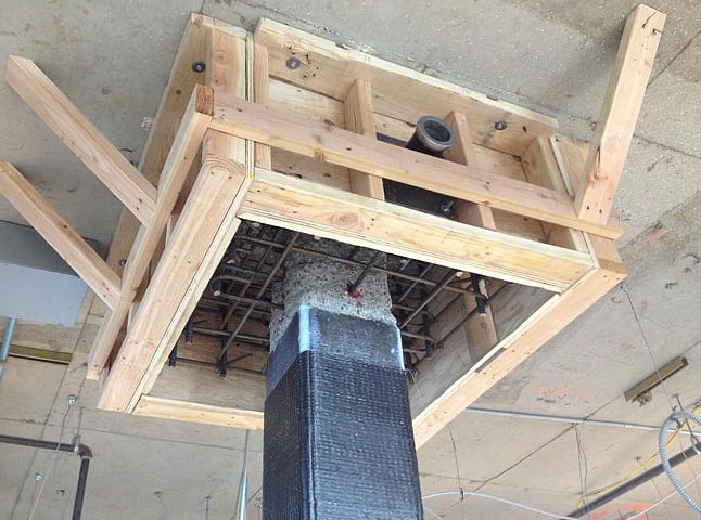

I think such soffit repairs need to be 'form and pump' from soffit using SCC and with the formwork designed for the increased pumping pressure where the SCC is literally 'squeezed' into the existing prepared substrate. Slide valves to the soffit forms enable the pump pressure to be maintained when the pump pressure is dis-engaged.
You state that your application is a continuous drop panel (I am thinking wide-shallow beam equivalent with/without beam stirrups) - so repairs may be at midspan and at column locations. Depending on the total thickness of the drop + slab, are you able to add additional vertical hooked dowels (adhesive anchored), and/or add a capital at the column locations?
The following is a common 'form and pump' soffit setup when making new column caps, but does not directly address your situation:
