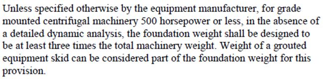

PIP states for pump foundation design the following:
Soil_Bearing_Overturning_Sliding_check_for_Vertically_Suspended_Can_Pump_Foundation_i4jpjt.jpg
Could this be interpreted to mean that as long as the foundation is sized for at least 3 times the weight of the pump, the Thrust forces do not need to be considered as acting on the foundation? If so, then would it not be necessary to consider the thrust forces for the soil bearing, overturning & sliding checks?

You are expected to use "Hyd Thrust" of 1,015 lbs for designing the foundation. This force is applied in horizontal direction , at center of outlet.
PIP states that, in the absence of dynamic analysis, for 500 HP or less centrifugal machinery , the foundation weight shall be at least 3 times the weight of the pump.
This is an exemption for dynamic analysis of foundation.
Still you are expected to check for OT, sliding, bearing stress, anchors....
First the foundation needs to be designed for all non-dynamic effects. Thrust loads, short circuit loads and "driver thrust" included. If that resulting fdtn mass is 3x pump mass and the pump's motor is < 500HP, a formal dynamic analysis that ensures that vibration frequencies and amplitudes caused by only the combined cyclic loads of both the pump and motor (i.e. not thrust, pipe pressures, or short circuit load, wind, seismic, etc.) acting on the combined pump and foundation masses are within operating limits, is not necessary.

I am checking for OT, sliding, bearing stress, anchors already, but I am wondering if it is possible to neglect the Thrust force in either of those checks.
It sounds like you're saying that the Thrust force should not be considered if the foundation is 3x the weight of the pump & the pump's HP is less than 500 HP. Would my interpretation of your statement be correct?

The vendor has replied back to my questions. He has informed me that the thrust for the pumps are vertical.
With that being said, it appears that the Thrust Force will not effect the sliding & overturning ( actually, if anything it should help in those regards).
Would it make sense to include the Thrust in the 3x the weight calculation to determine the size of the foundation? I would think that to be too conservative.
Suggestions/comments are appreciated.
I would consider pump weight only, somebody might do differently though. You need to take the thrust into consideration for sizing the footing though.
It is true that Thrust Force will not effect the sliding & overturning . The thrust (both axial and radial ) resisted by thrust bearings and pump casing. The vertical load on the base plate will not change for static and operation condition.
You can not include the thrust in the 3x the weight calculation to determine the size of the foundation. Weight of pump includes only the (pump, driver and base plate ..)
I will suggest again ; best call the the manufacturer and ask the design forces on supporting plate.
