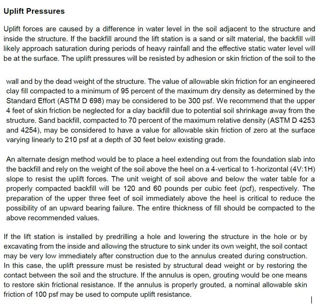

Our firm designs submerged wet wells and we DO include skin friction on our wells BUT the geotechnical engineer provides the skin friction value to us.
Some caveats:
We use a safety factor of 3 on the skin friction component of our buoyant calculations.
We have expansive clays in Texas so we have to worry about the clay shrinking and creating an annulus around the submerged tank/well. We have a general note requiring that the contractor grout around the well. On new construction they can use small grout ducts, but you would have to drill holes on a remodel.
Attached is the language that the geotech typically provides us. The actual values vary from job to job, but the language is pretty much the same from all the geotechs we use.
I'd use the free-body diagram and safety factors. The FBD includes side shear and horizontal/vertical forces - including both at-rest and hydrostatic pressure.

Joel... I would not normally backfill with clay... want a free draining material. Do you accommodate the swelling pressures of the clay on the tank?
Dik
In reality, we never backfill at all.
The geotechs always have language in their reports about excavating and backfilling with select fill or sand, but it's not really practical. The stormwater lift stations we design range in diameter from 10ft to 32ft and the depths range from 20ft to 70ft. I can't imagine how big an area you would need to excavate if you actually wanted to drop a lift station down into the ground in an OSHA safe way.
To my knowledge, all of the wet wells are constructed using the caisson method where the contractor just casts ~10ft sections of well and then sinks the well into existing ground. Thus the wells are surrounded by Houston clay. The amount of concrete required to sink the and overcome the cohesion can get crazy. I'm just the EIT, but in my 3 years; I have seen 36+ inch walls several times.
We will often provide lift station plans with 18" walls. The contractor will then submit signed and sealed shop drawings with 24" walls and not request a change order for the additional concrete (must be a high profit margin business or they bid the work knowing they are going to thicken the walls).
