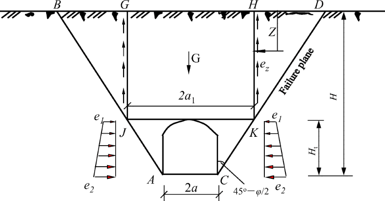

I'm designing the footings for precast tunnel shells. The tunnel is located 20m below grade and the footings are concentrically placed to the tunnel shell walls so as to avoid any instability.
Would it be correct to assume the soil column over the overhanging part of the footing can be ignored due to arching effects in the soil?
In my case, this is the difference between a simple strip footing and an expensive thick mat footing.
0 to 10m is loose fill material
10m to 20m is natural stiff clay overlying weathered rock (weathered rock layer about 3m below tunnel footings).
I would think that assumption is not safe. Any soil above the footing should be included to be safe. And I think it is more likely that there will be additional settlement that may even bring in soil load from outside the green area to the footing, but that depends on how the tunnel is to be installed. If the soil adjacent to the green wall is a solid rock cut, then no, however if the tunnel is to be installed after cutting down at a 45° angle and backfilled, I would think you would pick up some pressure from the backfill beyond the green column, including water pressure, if it were not very well drained.
If the tunnel is rigid / stiff relative to the soil I would think that the tunnel will pick up a large wedge of load and transfer it all to your footing. The load would be much larger than the green column, unless as 1503 says the cut face is rock (i.e. much stiffer than tunnel)

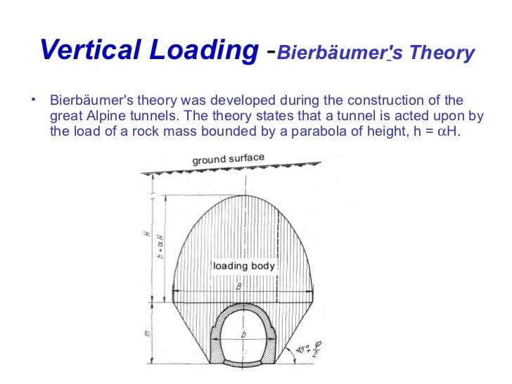

Most images in this search show loadings coming from a much greater contributary volume than the green column boundary.
Yes, the tunnel will always be more rigid than the soil, unless you drill into solid homogenuous rock.
These basic models are easy to follow and need only a few soil parameters.

Thanks for all the input. I think I need to clarify, the footings are definitely designed for the soil mass above the tunnel (as a vertical hydrostatic pressure from the surface down).
My confusion is about the part of the footing that sits outside the tunnel walls and if I need to include a column of soil weight over it (green shaded column in my first diagram).

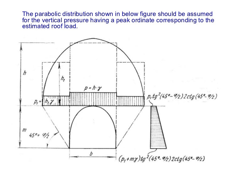

@1503-44, thanks for the references, it's much clearer now. Terzaghi theory shows zero vertical pressure at the corners of the tunnel increasing rapidly as you move away from the corners.
Yes, include that green column and more. According to the above diagrams, the effective width may be the width of the tunnel + 2x its height, if [ψ] is 0.

So any "arching" of the backfill would occur from where to where?
It would seem that the depth of burial (m+ [α]H, as shown in the first diagram above) of the tunnel would indeed have to be very deep in order to get any arching from failure plane to failure plane. The arching effect does not happen for soil within the arch shown on that first diagram. Only soil above the arch does not place load on the tunnel..
