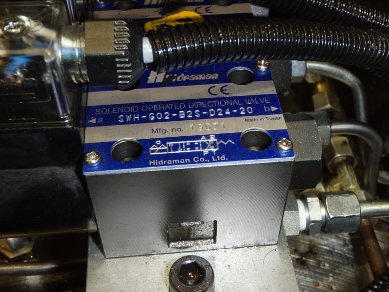

Why does the valve in the attached picture (Hidraman SWH-G02-B2S-D24-20) appear to show a detent on the 'a' solenoid coil, when the 'b' side is spring return?
I cannot see how that would be useful. Am I misreading the symbols?
If that is supposed to be a spring on the left, rather than a detent, I still do not see how it would make sense.
img ]
Marc Leonard
CNC Services Northwest
Something to do with Manual Override?. Its a 3 position mid position closed valve. Hence the two dents.
Pneumatic valves have them. I'm not sure about hydraulic ones.
It is quite simply a 4/2 solenoid valve, arrows crossed at rest, parallel arrows energized, with a closed transfer.
Thanks. I will assume that the zig-zag symbol on the 'a' side is just a typo.
