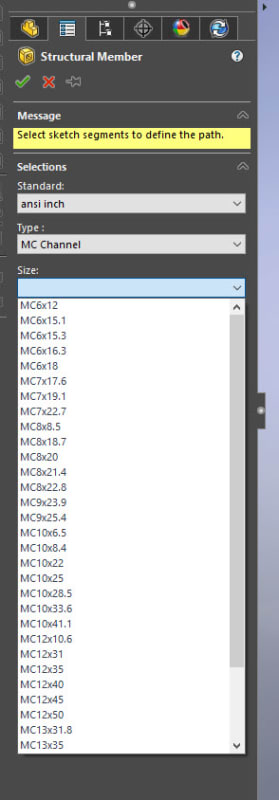

Try downloading the ANSI (or other standards if needed) of predefined weldments?
You can also make your own weldment profiles if there is not something there.

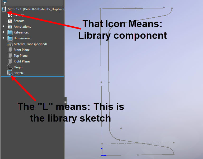

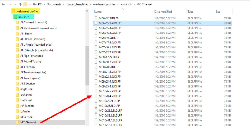

You will need to browse to the weldments folder and find one similar or make a new library sketch (see help for details on making your own library sketch its **important**). if you go to the weldments folder\standard you can copy, paste, rename then edit\change the sketch.
When you are in the library sketch (weldment Profile) You will see a couple of new icons:

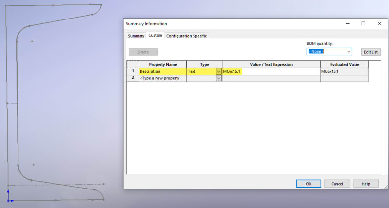

Also, change the custom properties of the new library sketch. That is where the information about the weldment is saved.
Save the file and try it out. Like I mentioned before you need to read the help on creating a Library sketch\component because there are few things you need to understand and do when you are creating or saving a file.
