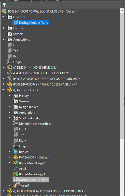

FYI try making whatever it is you have to scroll for a "favorite", (see an example of a Plane within a part while in an separate assembly) then you won't have to scroll anymore.

I usually do the reverse of that. I take an assembly and suppress all the parts\subs that are not needed and save the assembly as a part (multi-bodies), then use those bodies to derive a new part from. Then use the delete bodies command within that part and put the new part back into the assembly. Is it one-click simple, no it's not and I don't necessarily think it should be. IDK if Inventor is either.
Wow, I don't think I ever could have figured that out on my own. Reason one is, as you say, opposite of Inventor so it's contrary to my previous experience, and two, that one must delete the body and "recover" later. Is there a way to substitute? IIRC that's another Inventor productivity tool (but that's a flaky one that I usually didn't enjoy using).
The tip on setting the Favourite is also a nice surprise, but counter-intuitive. Thank you.
