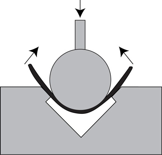

2. Second question is regarding spring back and special tooling for coping with it.
I encountered this tooling, and I am not sure how it exactly works for coping with the spring back.
Thank you!
For your second question... the extra little jags at the top of the die cause the sheet to bend more tightly when pressed into the die (the sheet bends to, say, 78 degrees while in the die), whereupon the springiness of the metal causes the metal to release a bit once the die pressure is released (back to the desired 90 degree angle).

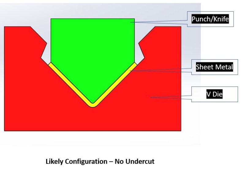

I am not sure I understand how the Relieved V Die works.
If I look at the Unlikely option, it seems useless and impossible:
If I look at the likely option, it seems that the special design of the Relieved V Die upper features are meaningless:
The "Likely Configuration" should show the sheet metal extending outside the die. If there was a link to the original diagrams that might also include an explanation.

Take your "likely configuration" and increase the angle of the punch so that the punch angle is smaller than the die angle (say, 10 degrees smaller). Now draw your yellow sheet to run from the die center to the nib point and continue outward from the die. The angle the sheet makes while pressed may be, say 85 degrees... once the punch is released, the springiness of the sheet will pull it back towards 90 degree. No undercut is ever formed.
EDIT: You can even have the die be nearly as wide as the nib opening, which can provide a bit of "channel" in the final corner shape, but you'll need to support the sheet outside of the die so the nibs provide a bit of back angle.

This is the image from 3DDave's link. Not a sharp punch, but a relief in a v-channel for a round nose punch.
