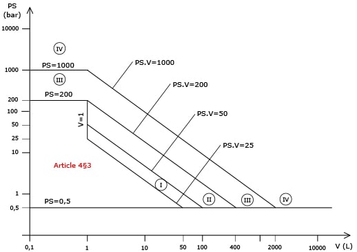

For the European PED they define different categories of vessels based on volume and pressure. Anything falling under the chart becomes "SEP" - in the past when I worked with SEP we designed to ASME BPVC VIII-1 as it was a shell/tube heat exchanger we already had ASME and CRN certified designs for. It was mostly an exercise in paperwork and writing up a letter to have our engineering lead sign to self-certify.
As far as I'm aware an SEP vessel is entirely between the customer and builder as to any design agreements, codes of construction, paperwork, etc.
Below 200bar and 50L where "Article 43" is shown in red is SEP.
