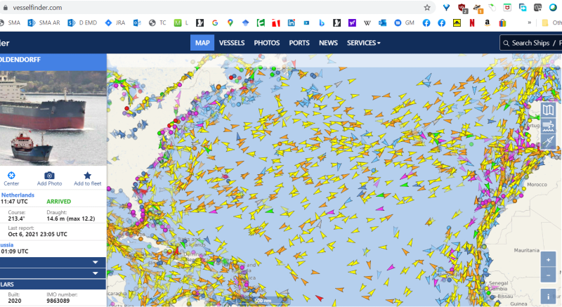

Apparently the nearest ship to it was meant to be nearly half a km away from it but the whole place is full of ships because of the huge backlog getting into ports with over 60 ships holding off waiting for a berthing slot.

Yesterday instead of the usual ZERO ships on anchor waiting there were 82 ships!! I could easily see a ship anchoring somewhere lame and snagging that pipe.

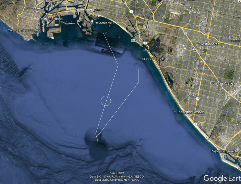

The setup ..
Looks like the pipelines were going around the designated navigation areas, so possibly they have only 3ft of burial depth.
