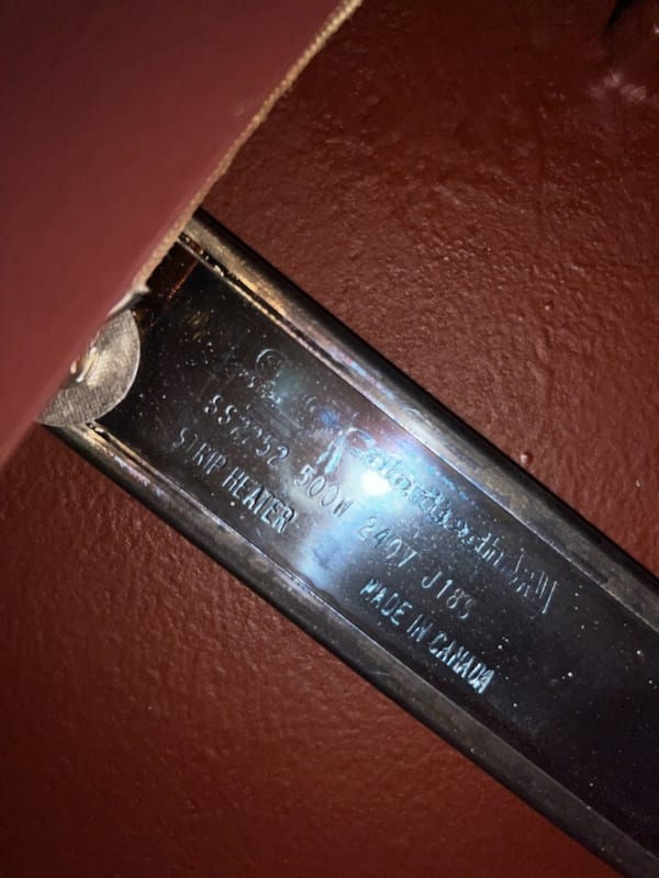

That is exactly what we have. Two 500-w 240V heaters in series per delta leg and we measure the expected current 3.5 or 3.6A. Photo of heater nameplate
And we measure in the ballpark of 3.6A on any phase for space heaters on all 8 motors, so I don't think there is any misconnection anywhere.
In effect, you are applying full rated (240) volts to each heater element. That means the surface temperature of the heater will reach its normal maximum design temperature ... which is in the 650-750 C range for the "standard" element length
I agree this configuration does not reduce the heater voltage in attempt to reduce heater temperature like many other applications do. This configuration is also mounted directly to structural steel which would certainly reduce heater temperature compared to a heater on standoffs. At any rate the one motor in question is the only one where the heaters glow (all 6 heaters on that motor) in spite of same current measured on heaters for all 8 motors and same heater type (same dimensions and nameplate) on heaters for all 8 motors. It suggests to me that there are no differences in electrical resistive heat generation but rather there are probably differences in the mounting and associated heat conduction characteristics like tugboat and itsmoked suggested.

electricpete: Interesting to see the close-up on that heater element. It may be that the shop used a carbon steel sheath in place of a stainless sheath design. This ultimately means that the surface temperatures will be noticeably different (up to 150 C in some cases, depending on other factors). In general, the more exotic the sheath material, the higher the surface temperature is going to be (because the sheath can withstand it, more than anything else). I mentioned 650-750 C range in my earlier post: this was incorrect. What I should have said was the following: (Sheath Material // Max Surface Temp in F) Iron // 750. Monel // 900. Chrome Steel // 1200. Incoloy // 1500.
What this means is that a circuit designed to use a more exotic alloy (e.g., Incoloy) will be severely stressing a lesser alloy (e.g., iron or Monel).

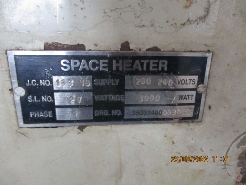

Presently, we are doing a refurbishment of a 11 KV, 15 MW, 1500 RPM flood damaged generator, where the stator weighs 18 tons and rotor weighs 9 tons. The space heater is only 2x1000 W, 240 V, single phase for the entire mass of 27 tons. The helical length of the heater ensures low surface heat density thus preventing any glows.
Muthu
