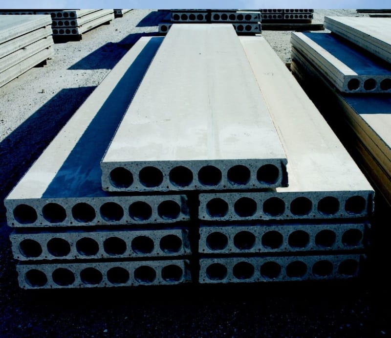

Does anyone know where I might find load tables for 8" deep 8 foot wide Span-Deck panels for and existing building? The building was built in 1977.​
What good will that do you? There are lots of manufacturers who produced hollow core slabs in the 70's, but the allowable load depends on the number, size and strength of strands.
I have the measurements from the field, I know the strand and cores measurements. I was just hoping someone might have spand-deck literature for that specific plank so I could better understand what load the plank might have been designed for.
The ones I am familiar with look like these, but they are not eight feet wide.
