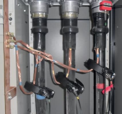

stevenal-At some point during the installation the bare neutral cable has to be bolted to neutral bus was already bolted to the enclosure. I have not directly seen the site, so I assumed the bare cable touched the enclosure similar to how the shield wires in this photo touch the wall.
comparison photo from
bacon4life,
I would propose doing the connections you depict first. The connection to the overhead system neutral at the other end would be done last with a hot stick. This way the workers are never in the circuit.

Stevenal-I had assumed that the practice of using insulated tools and appropriate PPE was required due to the possibility of fault currents rather than due normal neutral currents. The fault currents could be 2 orders of magnitude higher than the normal neutral current. Is there any reason for arcing would different depending which end of the neutral was made up first?

The arcing current when the last connection is made would be the same, but the stick ensures that last connection occurs away from the worker while keeping the worker outside the path. The rule I know is always connect ground end first, system last. All of this would be gone over during the tailboard job briefing.
I believe your estimate of 1- 2 volts might be low. According to Alstom, Ra=28710*La/Ia. Ra is arc resistance in ohms, La is arc length in meters, and Ia is arcing current.
