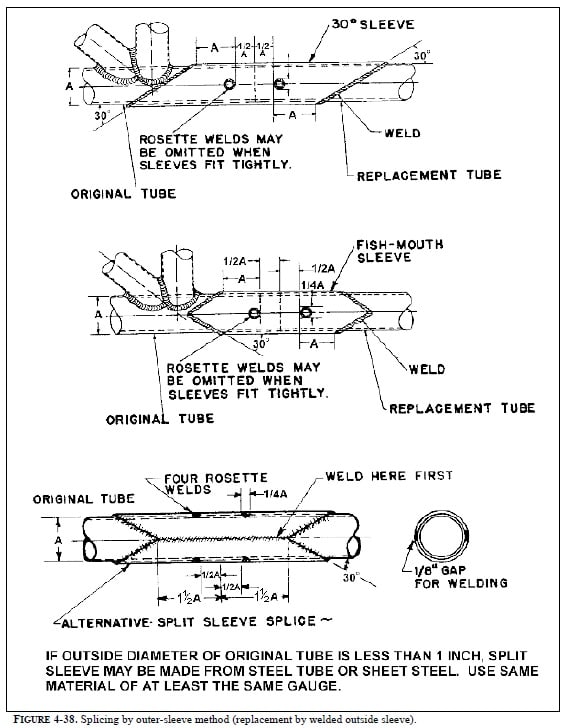

AC43.13-1B Figure 4-37 or 4-38?

As I understood the problem, this this control-tube has-to be re-assembled in place in the aircraft; and that a secondary component is operating thru the middle, end-to-end. Welding wasn't an option.
Regards, Wil Taylor
