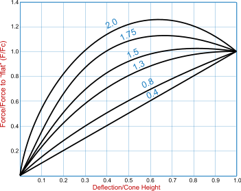

The attached seems interesting, since it implies that certain forms of the washer are capable of retrograde spring constants, i.e., increasing force with decreasing compression over a limited range.

That is the intention; gasket creeps and the Bellevilles decompress to occupy the gap. The Bellevilles we use have a ratio of 1.2 so should be fine on that graph. I'd also heard about the deflection percentage so good to see an actual source for it!
I think you missed my point; you want to be closer to 2.0, since you want to maintain nearly- constant compression force, regardless of the deflection; so also closer to the right side of the curve, ideally, since that would also increase the compression force if the gasket creeps

You should not compress disc springs beyond 70 to 80 % of their height. If the springs are scragged, then you know they can be compressed to 100% without breaking. However, the load vs. deflection curve increases significantly once you go above 70 to 80% compression. Above this range, the load vs. deflection equations are not accurate.

The cone height to thickness ratios for Belleville spring washers designed for flanged connections are usually quite low, giving a very linear spring rate as shown in the above diagram. To get significant deflection they may need to be stacked in series, but this lets them be compressed to flat without damage.
