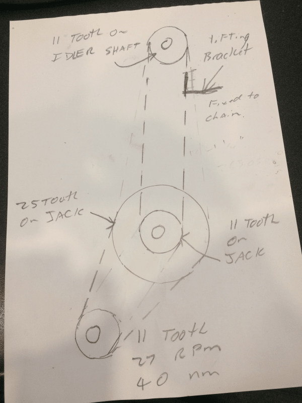

Thanks for your ideas. Im having a blond moment. Are you saying that if i have an 11 tooth on motor output driving a 25 tooth on jackshaft ( this is one complete drive circuit)
NEXT
if i then run an 11 tooth from jackshaft (output) to an 11 tooth at the top ( 2nd drive circuit) and i connect my lifting point on this chain ( as shown in last pic) then this point shout be able to lift 425KG --
I have a funny feeling that i am missing a drive circuit or is the final drive being attached to the 2nd circuit chain ok?
sorry to be vague but have attached a hand drawing of what im thinking is the answer to YOUR comments. Is this correct?
thanks

Your diagram is of an 11 tooth sprocket driving an 11 tooth sprocket.
Your sprockets are mounted on shafts far from the support bearings. "Far" means many times the shaft diameter. The bearings are mounted on thin flat plates. "Thin" means relative to the span of the plate. You have a tie-rod support with a thin, bent strip of metal in the load path. All of this adds-up to flexible. You seem to have little understanding or feel for how shape affects stiffness. C-channels or hollow square shapes can have ten times or more of the flexural stiffness of a flat plate of equivalent weight.

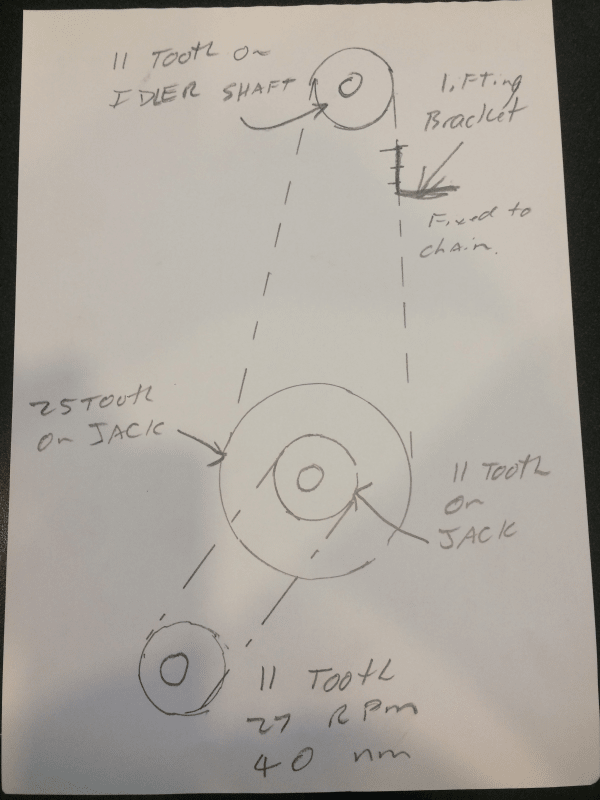

i thought my diag shows a 11 driving an 11 then a 25 fixed to same jackshaft driving the top 11.
I assume ive got it horribly wrong BUT re reading your initial post i thought i had followed your plan.
is it possible for you to sketch WHAT you actually mean please . As stated the ONLY restriction is the diameter of the TOP sprocket.
Appreciate yours or anyone's drawing
thanks
Nope I wrote: 11->(25 joined to 11)->11 is what I suggested. 25 teeth on the input to the intermediate shaft turn 11 teeth on the output, decreasing speed and increasing force.
You have 11->(11 joined to 25)->11, so your diagram is a gear speedup and torque loss method. 11 teeth on the input turn and run 25 teeth on the output increase speed and decrease force.

Your most recent sketch is better. Now you have a reduction ratio that will increase force by 25/11 (2.27:1) at the expense of speed. The top idler sprocket does not factor into your lifting force. The sprocket on the motor and the two sprockets on the jack shaft do.
Depending on your lifting needs, you can use something equivalent to an ANSI link that provides a mounting point for other items. Be aware of two things - 1. check the load rating for the link and provide adequate safety factors 2. When lifting directly using the chain, you will create a moment that will want to "bend" the chain (not from the side, but in the same direction as its links. That may or may not be an issue for you but it may induce extra tension in the chain.
Also check with companies like Martin that have extensive documents on chain drive design and sprocket sizing recommendations.
Finally, since you are lifting something, make sure you have plenty of safety factor in your components.

thanks for the confirmation-comments
i have created a LOOP in the chain as shown in pic 4 above. this encircles the lifting bar and works remarkably well.I hope a 428 chain should lift 80kgs with no problem
