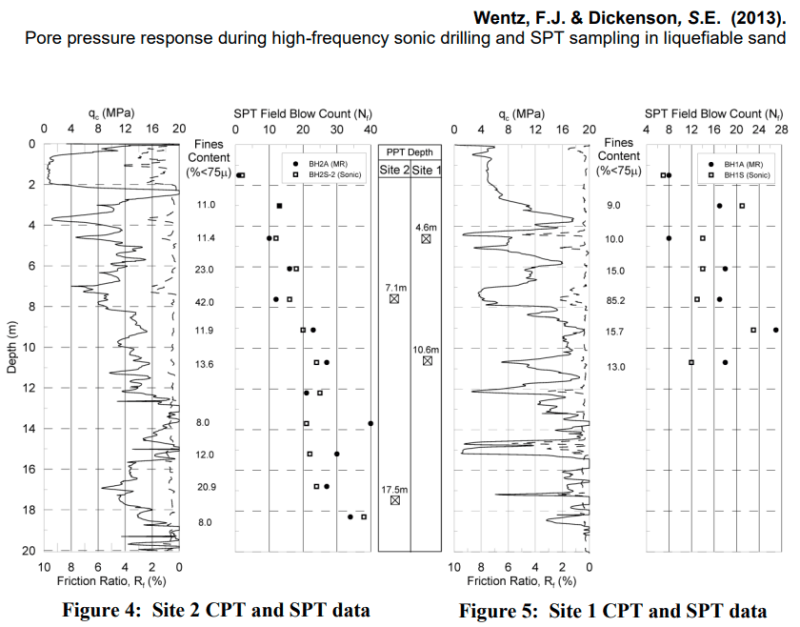

Some people argue that sonic drilling does as it can loose or densify sand. Sonic drill promoters refute this.
I have attached an image from a 2013 study and from my personal experience comparing CPT results to SPT's completed by sonic drilling there is an influence of moving the N value closer to the critical state line by densifying loose deposits and loosening dense deposits.
Good insite GeoEnv, I dont have enough experience with sonic to comment. But as I have said, I have seen people argue the fact.
However, your information above is pretty damming. Sonic drilling is evolving very quickly so I would be interested so see if a newer rig would make any difference. Surely the sonic drillers have done these comparisons.
What was the frequency of the sonic drilling. I see people promoting 150Hz as the standard
