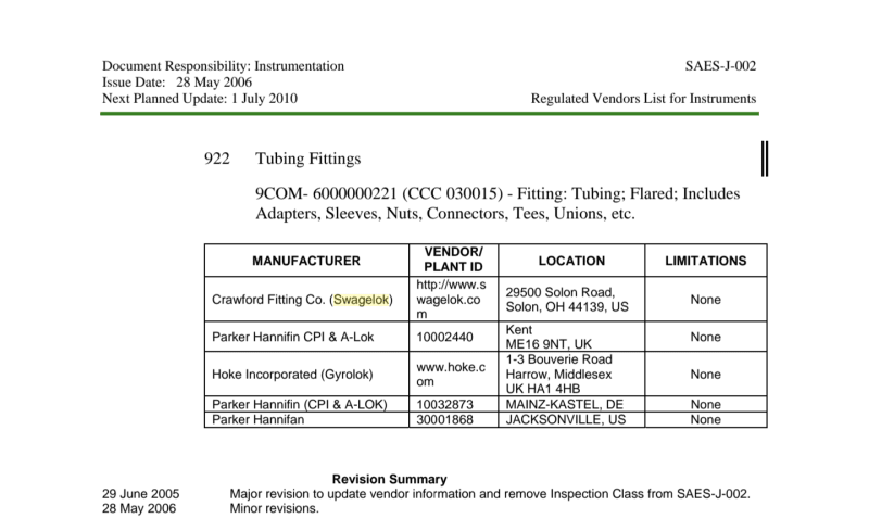

Mar 21, 2023 #1 ncnpiping Petroleum Jan 1, 2023 14 0 0 SA Is a union straight coupler allowed in the SA Aramco system to connect two 0.5" SS tube?
Mar 21, 2023 #2 TugboatEng Marine/Ocean Nov 1, 2015 11,388 1 36 US Does this help? Select suppliers have no limitations. Upvote 0 Downvote
Mar 21, 2023 #3 HTURKAK Structural Jul 22, 2017 2,844 0 36 TR Couplings are socket welded .. For SA Aramco Desktop standards regarding SS tubes , pls look the relevant PIP..PIP PN06SJ0S01,PN06SJ1S01,PN09SJ1S01.... Not to know is bad; not to wish to know is worse. NIGERIAN PROVERB Upvote 0 Downvote
