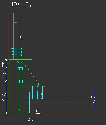

I am curious how would you handle stability issue for this case. I have a 6.4m long beam, height of the beam is 0.45m (IPE450). It is loaded on bottom flange with CLT slabs. In the middle of the span there is quite large point load on top flange from a column above. Beam is simply supported on both ends, lateral support is the same as in span.
You can see in the detail I provided brackets to connect top portion of the beam with CLT slab. Brackets are spaced 1m O.C. by entire length of the beam. Connection with wall should be neglected as it will not provide lateral stability.
I use Eurocodes but you can give you opinion on it regardless of code. For now I designed the beam as laterally supported and designed the bracket and screws based on lateral force (2% of compression force in the top flange). But I have second thoughts.

1) In general, I would do as you have done and attempt to lock the beam rotation to the flexure in the CLT slab.
2) I would like to see a strap and screw arrangement at the bottom of the CLT slab similar to what you show at the top. With that, I'd probably ditch the triangular bracket.
3) If it makes sense to do so, I would attempt to create at least a nominal moment connection between the column and the beam torsion. This may not be theoretically necessary but, when a major, destabilizing load is being delivered in a concentrated fashion, I feel that it's good practice to have some concentrated LTB restraint nearby.
4) Even with the arrangement as you show it, I would approach things a bit different analytically. See the sketch below. I would be treating this set up as torsional bracing rather than transnational. The US steel code has provisions for the strength and stiffness of such bracing schemes.

5) The 2% business is intended for transnational bracing where as you really have torsional bracing. Perhaps the 2% rule can be modified accordingly but, at the least, I'd think that you'd have to amplify the requirement somehow to account for the lateral resistance being applied at a different level than that of the top flange. You may well have accounted for this already, I'm not sure.
6) It goes largely unsaid but the 2% rule intrinsically assumes that the thing being braced and the thing doing the bracing are of the same material. That's how the rule somewhat gets around having a stiffness requirement when, in reality, brace stiffness is usually more critical than brace strength.
There is a publication, on page 38, where they state that lateral force is basically just 1,25% Nd if you have more lateral supports. I also added wind force from wall above.

a) Did you intend for your lower screw to be part of the LTB restraint system?
Yes, I assume the point of rotation is at the bottom flange. I have screws 8x160mm @ 250mm along the entire beam. Distance from the edge of CLT is big enough to develop full shear capacity. It is highly unlikely top flange will rotate towards inside. It will rotate outside. I designed the triangular bracket with screws for this case.
That assumes that the brace resisting force is provided at the level of the flange. So, at the level of the top of the slab and assuming rotation about the underside of the slab, you'd use a shear force in your bolt group of about 2.5%, right? You may well have already done this, I'm not sure.
Yes, KootK, I have done this way. Now, I'm not sure about screws at bottom flange. How would you calculate force there? Should be the same as for the bracket, right?
For that, I think that you need to consider the top flange rotating to the interior about the top face of the CLT as I showed in my sketch. I'd think that 1.25% would be fine there based on the lever arm. My gut feel is that your screws at 250 o/c should be fine.
