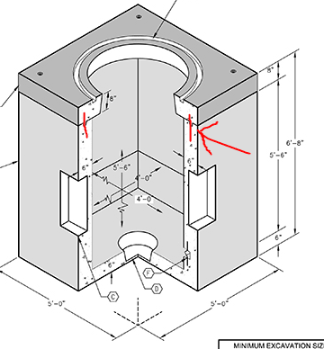

What are the benefits of using a Stainless Steel Anchor Rod vs Galvanized Anchor Rod inside of a Lift Station/Wet Well?
The anchor rod is inside of the Wet Well, connecting the wall to the bottom of the slab (see image):
Initially, to me the benefit of using just a galvanized anchor rod is that I can use a higher strength steel (both yield & tensile strength). But the concern is that just using galvanized anchor rods would not be sufficient to resist corrosion due to the constant exposure the anchor rod would have to resist based on what is inside the wet well.
I am trying to determine the best rout to go regarding this connection. Stainless steel seems to have a much lower available yield & tensile strength. But I am not sure if galvanized steel would endure as long as stainless steel.
Comments/suggestions are appreciated.

Apparently, this is valve chamber rather than wet well of a P.S. The concrete surface, anchors angle subject to splash and heavy humidity .
The detail imo, constructive rather than structural requirements . So, the strength of bolts should not be an issue.
My suggestion will be, if the angle L 6X4 is stainless steel, the anchors SHALL ALSO BE ss. or, alternatively choose galvanized angle together with galvanized rods in this case, epoxy grout extending to 300 mm wall ht will be helpful for protection.

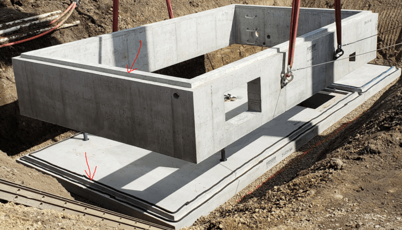

Also, would anyone have an alternative way to connect a cast-in-place bottom slab to a Precast circular riser wall (other than the angle connection shown in the image in the initial post)?
A few options 1) You can do dowels or pins as they are called. 2) Do a groove or step around the perimeter for the wall to rest in. 3) Post install the dowels after the walls are set and cast a curb around the perimeter.

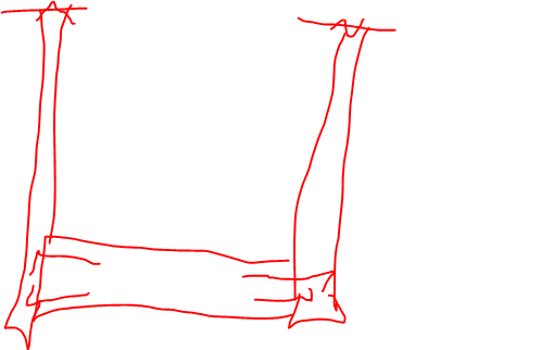

#1 Shear pin. I dont have image available but mark up should get the idea across. Probably the least common approach

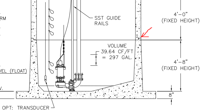

#2 Base slab with step
#2 Base with integral starter wall for step

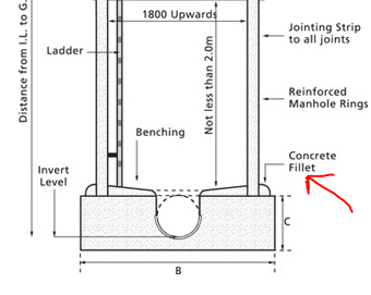

#3 Base slab with curb/fillet without dowels but you can image drill a hooked dowel into the slab then the hook is in the curb/fillet.

If this is the caisson method, you should dowel in the wall or provide couplers then pour the base slab inside of the caisson. No reason to have a toe on the base slab.
