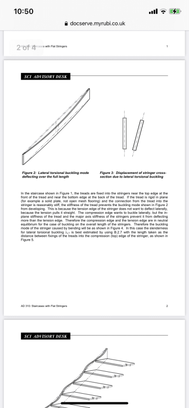

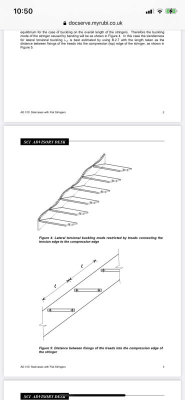

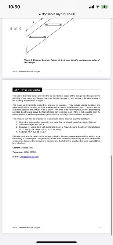

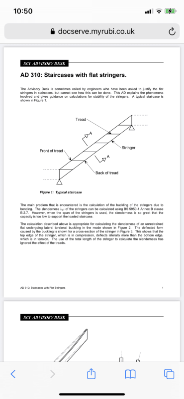

See below simple guide
MIS... do you have a better copy of the doc? Thanks
Sorry about the quality dik. Just put it up from the phone today. I’ll upload properly next time I’m at the laptop.
Thanks...
Yeah MIS.. seems like a great resource to have. Please share it if this is a public resource.
