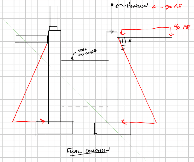

Hi all. I got a call on a retaining wall that someone is installing to access their basement. As shown below there will be a set of stairs down to the basement. One side of the stairwell is a new retaining wall, the other side is an existing 7' tall foundation wall below the garage. Apparently the garage fnd wall had to be that tall to get down to good bearing soil. The reason I got a call is because the builder already had another engineer detail this retaining wall, but the builder thinks it's overdone. It was engineered as a true cantilever retaining wall, so it ended up with a 12" deep x 3'-6" wide footing, #4 bar at 12" on the retaining face, #4 bar at 12" longitudinal. In my opinion I think the other engineer did what technically "should" be done on a wall like this. However, I will admit that I have done stairwell walls like this before with a 20" wide footing and #4 bar at 16" in the center of the wall, with the reasoning being that the concrete stairs provide bracing against sliding and overturning for the retaining wall as they go up. With the stairs providing bracing, lateral soil pressures that will most likely never develop, tying the new wall into the existing concrete on the side of the doorway, and the short length of the wall, I figure that a retaining wall that will triple the owner's cost is unnecessary.

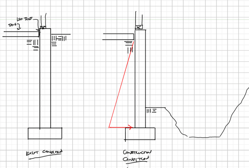

I believe Pham's concern stems from the construction condition of the existing wall, the garage slab on grade is likely isolated form the top of wall:
For the final condition your going to need to use the stair to actually brace the existing wall out to the new stair retaining wall. You could analyze it on a strip basis or use something like the PCA below grade tank guide, or any software package that can handle plate/shell elements. Don't forget the handrail load on top of the new foundation stem along with residential surcharge on the new foundation and garage surcharge on the existing wall.

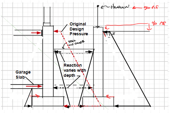

@Apache1,
You have changed the loading on the existing wall from a linear varying pressure to mixed with a concentrated load at every step of the stair. As a propped cantilever, the steps will receive a considerable amount of force, and, the load is varying with the height, which can cause an adverse effect on the existing wall. All these additional forces/effects could be manageable by the existing wall, but it needs to be verified. Is the saving worth the verification effort? This question can only be answered by you. The contractors' engineer obviously said, "not". :)

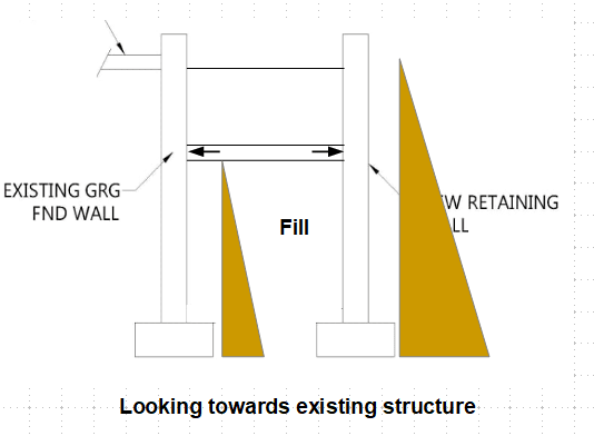

I think the diagram below shows the difference in pressures/forces on the existing wall when complete. I personally will do a quick and dirty evaluation to see the difference numerically.

Seems like it would improve the existing wall performance to take some soil away from it.
Still thinking that the soil load from the new stair wall is not significantly different with or without the stairs there.
