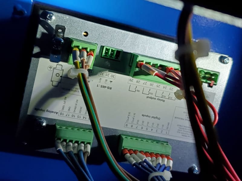

I figured, "well if it's S/D then they need a timer, I'll find that to confirm it".
No joy, as the whole thing is run from a black box which is the front control panel. Could be a timer could be a Dahlander load adjuster.

Hello Mr Yau. I don't see any overload..? The far right thing is the control transformer with a couple of fuses and some additional fuses between the transformer and the right contactor.
No drum switch, an electronic control unit.
I don't see an overload anywhere nor even a current coil.

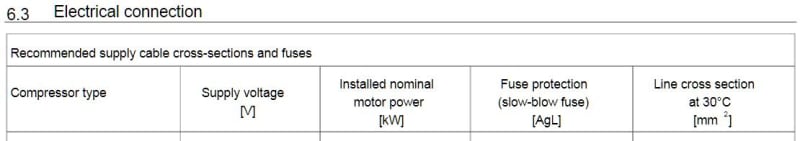

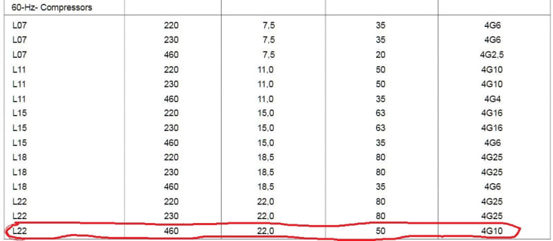

Found a manual for the machine but of course the ONLY thing left out is the schematic.

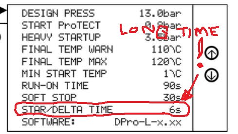

I did see this:
I don’t think 6 seconds is a long time for an air compressor. Is it?

94A @ 460V doesn't sound right for a 30HP motor so you may want to verify that if picking a transformer.
Yeah, your current is way off, either that's the current at 230V, or it's a 75HP motor at 460V.

The lack of a transition timer would be the tell-tale sign of it not being Star-Delta, but then you posted the controller, which may be handling that function too. So finally, that data sheet showing the "Star/Delta time" is likely the determining factor, that and the fact that having a 2 speed Dahlander motor on a compressor is somewhat pointless.

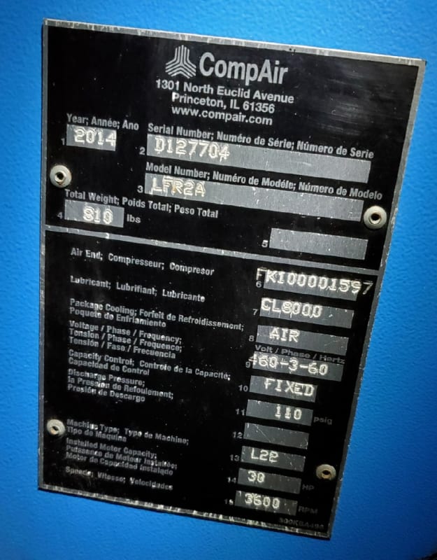

badservo et al; 94A seems way off-base right?
It has a separate fan for the heat exchanger but I doubt it's more than 1hp.
This label is inside and you can see the edge of it in my first picture at the top of the thread.
And here's the EXTERNAL plate:
I looked at the outside "460V" then opened the machine and saw the "93A".
Now I see the inside plate stating "200V".
30hp @ 200V = 80A.
Yet you feed this machine 460.. There are no transformers anywhere.
Why oh why would they label it 460 outside and 200 inside?
This is in the manual. I think this is what Jeff's talking about. No protection in the machine at all and you're supposed to follow these instructions and reading carefully between the lines provide it outside. "if the 'switch' doesn't provide overload protection add fuses". Cripes!
