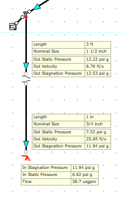

Hi fellow members.
I am working on designing a wet pipe fire sprinkler system for a small room and I am using "Fluidflow software" to perform the hydraulic calculations. I am stuck at a very simple concept but I need your help in clarifying that. Sprinkler manufacturers recommend that the sprinkler operate at or above a minimum residual (flowing) pressure of 7 psi. Now my question is, when we look at the pressure available at the sprinkler head, do I look at the stagnation pressure or the static pressure? For example, for one of the most remote sprinklers, the stagnation pressure is coming out to be 7.72 psig and static pressure is 2.35 psig. Should I be comparing the stagnation pressure (7.72 psig) to the min. requires pressure (7 psig)? Appreciate the help and support.

Thanks for your response. Regarding the use of terminology, this terminology is from the software itself and this is what I am not clear about myself. Also, how are you implying 7.72 psig is low if minimum required is 7? I am only asking so I can further improve the system design if we need to have a certain margin above this minimum.

And from the definitions provided it looks like static pressure is your flowing pressure upstream of the sprinkler.
Stagnation pressure is pitot pressure or the pressure seen at flow =0 in a tube facing into the flow.
what sort of velocity do you have there? 5 psi difference between the two seems quite big to me.

Thanks 1503-44 for the great explanation. Will this required pressure be classified as required "stagnation" pressure or required "static" pressure? Fluidflow software is giving me an option to view both the available pressures at the sprinkler head when it is flowing at the required flowrate (in my case 38.9 gpm). I am not sure which one to look at for this compliance.

Now when you stick 5psi difference into a pitot tube calculator for water, it tells me that your flow velocity is >8m sec. That's very high and will be causing a lot of pressure drop.
Now I don't know what you put in the program, but my guess is you put in flowrates and asked it to calculate pressure.
Your sprinkler needs >7psi when it is flowing to work properly. Your system at the flowrate needed is only giving it 2.35 psi. Therefore it will dribble and not sprinkle.

I don't think we are. Your analysis program is confusing you by referring to the stagnation pressure for some reason, which is not often used. "Static pressure" is more commonly just called "pressure" as it is the one you can measure by tapping a hole in the pipe and installing a pressure gauge or transmitter. Stagnation pressure is only used really for pitot tubes.
Your analysis clearly shows that during operation the (Static)"Pressure" is 2.35 psi. This could also be called the residual or flowing pressure.
Check your inputs. Your figures (stagnation pressure minus (static) pressure when input into a pitot tube calculation) show that you have a flowing velocity at whatever point this is of >8m/sec. So you may have either have input a very large flowrate or a very small pipe. This is a very high velocity for any system.
I dont see any conflict here. Its all good stuff. Go back to the beginning and read all of them again.
7 psig is the minimum at any time, static or flowing, although you may need a lot more than 7 to deliver your flow at any specific sprinkler. That is all you really need to know. Check your output for numbers less than 7. If you see one, you have an error.

I changed the parameters slightly and increased the static pressures as suggested. I am attaching a screenshot of one of the sprinklers below. I have tried including all the parameters for your reference like pipe size, length, flow, velocity, static and stagnation pressures. Can you please have a look and let me know what you think of the results now? Many thanks for your support.
