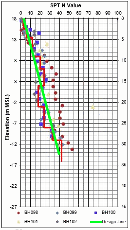

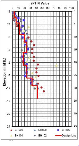

I recently got slated by an external review of a report for the below SPT graph. The reviewer was adamant that I had to use a "statistically derived characteristic design line". I havent actually got around to preparing a "statistically derived characteristic design line" for the chart. However, I believe what I had done was quite reasonable.
But my response was, "why do I have to use a a "statistically derived characteristic design line" and the response was that "any time you are assessing data you need to use statistics". The theme continued through the report review, with everything requiring assessment by statistics.
I found it quite weird tbh, that someone was so adamant that statistics had to be used.
Suppose I have a commercial site that's 200mx150m in plan. I do 10 boreholes with a diameter of 150mm and carry out SPT's at 1.5m intervals. Lets say, rock is at 10m.5m, so I get 7 spts a borehole. There is 300 thousand meter's cubed of soil above the rock. My boreholes allow me to see less than 2 meters cubed of soil which is less than 0.0006% of the soil. The SPTs have tested even less than that.
What use are statistics?
I suppose it could help but I've never found any use in doing anything other than averaging
I would ask the reviewer what type of statistics he/she would like to see used? Should it be an average, a weighted average, a 1/3 and 2/3's split of the data, etc.?
Statistics can be used in some situations, but those situations are generally limited in the real world of practicing geotechnical engineers.
The reviewer's comments remind me of the saying: Measure with a micrometer, cut with a chainsaw.

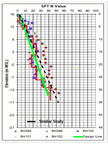

ErieChch - Thank you. Perhaps what the reviewer means by a "statistically derived characteristic design line" is a best-fit, mathematically calculated linear regression line, similar to the green line that I "eyeballed" on your graph:

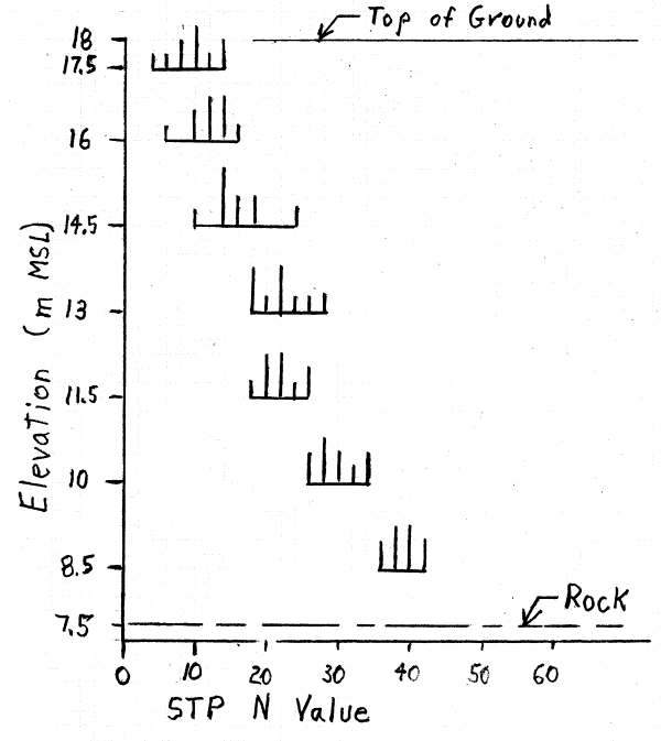

geotechguy1 - For your example, if all I had was the 70 data points (10 borings with 7 STPs in each),for my own use, I would prepare a graph that presents all the info graphically, on one page. Here is a sample, with data I made up:
The height of each vertical line of the graph is proportional to the number of STPs at a given elevation with the same value of "N". A graph like this tells me quite a lot, such as how much the blow count varies at a certain elevation, and how blow count varies with depth.

A regression line provides meaningful interpretation to the data points collected, and is ease of comparison. Piggyback on SRE's idea, the statistic chart/graph can then be compared/correlated to other known data sets to validate your work.
