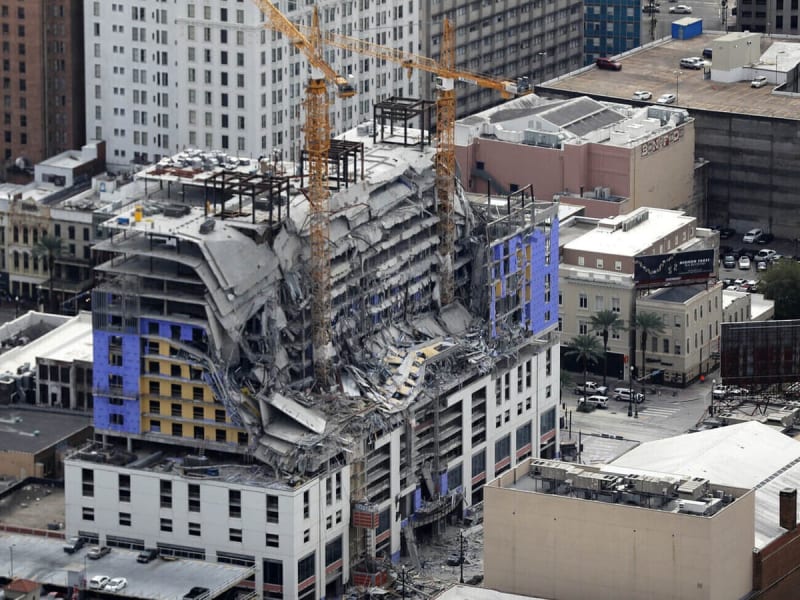

You can also say the opposite ==> Hard Rock Hotel in New Orleans, for example, was constructed in structural steel that 'pancaked' whilst under construction, however , the 6 levels of concrete (actually post-tensioned concrete) framing survived.
