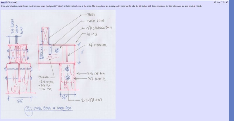

My architect is telling me that he will not allow me to install a horizontal load-bearing steel beam that is supported by 3 2x6 existing vertical posts on either side. The posts sit on the foundation. I am being told that a steel beam can only rest on a steel post. (Something to do with different rates of expansion and contraction?)
I would prefer to have them supported by these wood posts, rather than rip out most of the wall to install vertical steel posts.
Should I be pushing back on getting him to allow me to rest the horizontal steel beam on vertical wood posts?

If this is an interior (heated) application such as an existing family dwelling then thermal effects will be negligible. If anything vertical steel poses more of an issue in that regard since it wont expand at the same rate as the wood framed wall. Anyhow, you can absolutely place a steel beam on wood columns but detailing the connection can be tricky to ensure proper torsional restraint.
See many eng tips threads on the topic

And this one where you'll find the following detail from KootK
Yeah, steel beams are supported on wood posts all the time in residential construction.

There's nothing wrong with using a steel column. If you are comfortable with the loading and the connection, then explain to the architect that
a) thermal variation inside a conditioned building is minimal and, besides, the beam and column are orthogonal to one another - who cares if they expand/contract at different rates? The bigger worry there would be the wood nailer on top of the steel beam. But there isn't a worry there. (Maybe don't bring that part up...)
b) the capacity of the wood column is sufficient to carry the load. Steel is rarely needed in residential for strength...it's usually for deflection concerns over long spans. The reactions are usually quite manageable.
c) if you really want me to use a steel column, I will. But it will likely be more expensive for your client.

I've used that detail from Kootk several times with the bottom beam tab which slides into the gang stud pack or engineered wood post bolted into place. One builder I work with cuts off the bottom tab of the beam and simply rests the beam on the column claiming that the joists that run above the steel beam will brace it. That is not a solution I'm willing to seal as I prefer a positive connection.
One thing you absolutely have to watch out for when using wood posts is bearing on a wood sill plate. For high loads, the 500 psi compression perpendicular to the grain for SYP will be insufficient to transfer the load and avoid crushing. In these situations, I generally oversize the post to spread out the load or use PT LVL sill plates. Bearing becomes the item you have to start chasing especially if the post is located on an upper level.
