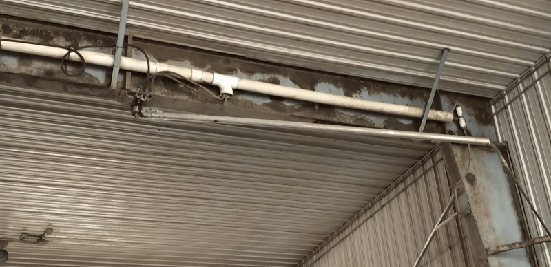

I am working on a PEMB that will be in a very harsh chemical environment. We are considering galvanizing, but we would like to consider some other options. Does anyone know of any other coating that might hold up to this type of environment. I'm concerned about the primary members, but I think the secondary members will be the bigger challenge. Any thoughts?

Thanks for all of the good responses. After looking into this a bit, I think the chemical that's causing the problem is ammonia, but I will need to verify. Has anyone heard of ammonia exposure causing this? I have looked into HDG steel and SS as a fix, but I am seeing some conflicting information regarding both. Has anyone had any experience with HDG or SS exposed to ammonia?
