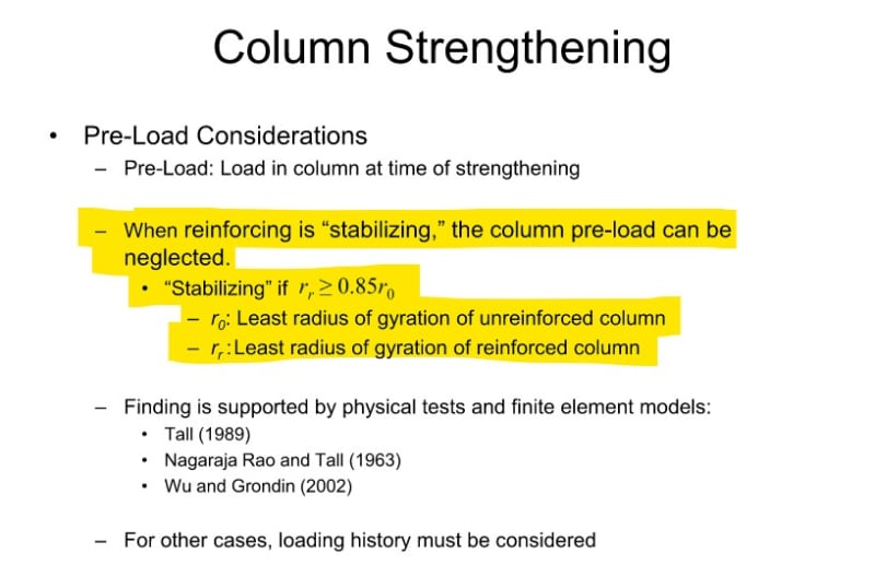

Further to your comment regarding pre-loading KootK, I came across the following from the AISC webinar for steel strengthening. They have noted that the pre-loading can be ignored if the reinforcing is "stabilizing" and meet the noted criteria. I am not sure what "stabilizing" mean. I also did come across a few research papers noting that the pre-load had little effect on columns governed by flexural buckling, or flexural-torsional buckling.
I will like to consider the AISC condition for my compression member reinforcement for future projects. However, I will like to understand the rationale behind this.
Welding steel plates to a column will cause weld-induced distortion. This distortion is large if you weld badly (one long weld) and with too thick welds, and small if you weld in a smart manner (stitches and then filling the intermittent parts) and with a suitable weld size. Welding specifications (which affect heat input and thus distortion) are also important. If the column is loaded, the above mentioned distortion can cause p-delta effects.
As far as the AISC figure goes, it states that "stabilizing reinforcing" does not greatly change the smallest radius of gyration of the column. If your column is symmetrically reinforced in each cross-section (or reinforced along the entire length), that is automatically satisfied, so I'm not quite sure of the use of that criteria.
When considering this, mentally replace ry with SQRT(Iy/A). The intent is more transparent that way.
This is best illustrated by considering two, extreme cases:
1) CASE 1: reinforcement is accomplished by increasing the area of the column receiving axial stress to a greater, relative degree that increasing the flexural stiffness. A ridiculous example might be reinforcing a wide flange column against Iy buckling with a couple of round bars welded to the web. This would increase the cross sectional area of the column but to little to improve Iy. This setup, obviously, would be very sensitive to how much stress goes where, when. Less good.
2) CASE 2: reinforcement is accomplished by increasing the flexural stiffness to a greater, relative degree than increasing the cross sectional area receiving axial stress. A practical example might be reinforcing a wide flange column against Iy buckling with a couple of plates running across the flange tips. This would increase Iy substantially and is a much stronger form of slender column reinforcement in many cases. This setup would be less sensitive to how much stress goes where and is the justification for the recommendation that you mentioned above.

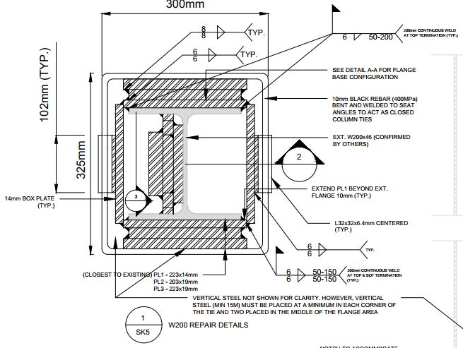

I'm on a job right (as the fabricator) where we are strengthening some corroded building and garage columns. Since it's reasonably related thought I'd share some of the details.
Here are some typical conditions. Scary that some of these columns were (are) supporting a 4 story building. IMHO I probably would have gone with complete replacement rather than the reinforcement. I imagine the EOR shy'd away from that since it reconciles you to have to shore the building for the design loads, which would be more expensive than what they did (they picked up the framing members just beyond the columns at the basement level only and shored to the SOG).
This is the repair. Lots of jogging out of plates to by-pass fastener heads and base angles. I had the existing steel tested and fortunately was confirmed to be weldable.
Picture of it in-progress. I don't particularly love the transverse weld we did at the top of the first flange plate for obvious reasons but we did it because the EOR wanted one (I would have just made the plates longer to get the required weld). I didn't push back on it because after seeing the columns I'm pretty sure whatever load they had originally is already somewhere else, and as a result wasn't too concerned about disturbing the (non-existent) stress field. That said, to mitigate the issue somewhat we welded the verticals first, then we welded half of the transverse weld, let it cool and then welded the other half. If I had been super concerned about the stress field I would have tapered the plate or said no to that kind of weld all together.
