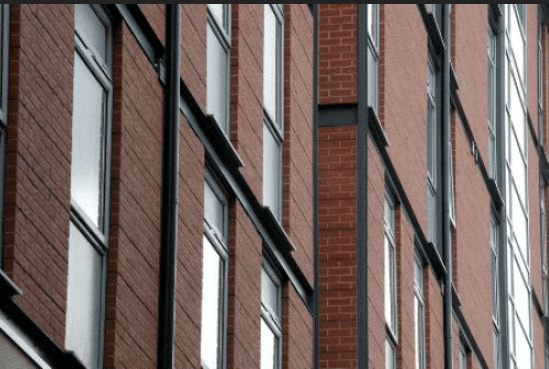

Note that the first two photos in le99's post are steel frames with masonry cladding, a somewhat different (typically better, although more complicated) system than a steel frame with masonry infill (as ahown by the OP).
