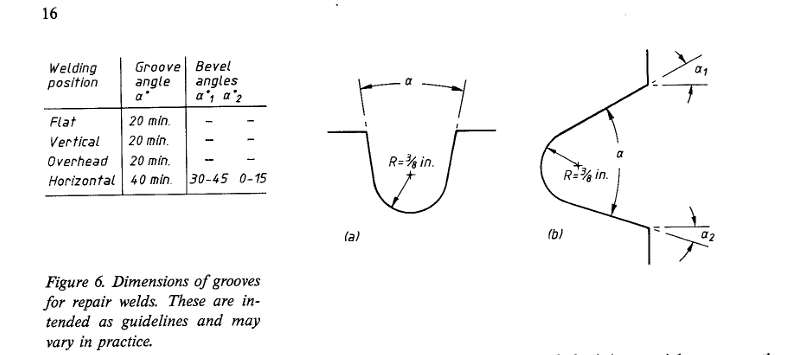

My first thought would be to make the cut into a V-groove or enlarge the cut to form a butt joint. Then fill the gap with a weld, like maybe a CJP type of weld. Not sure if that would create fatigue issues or how weldable that steel is since it looks riveted.

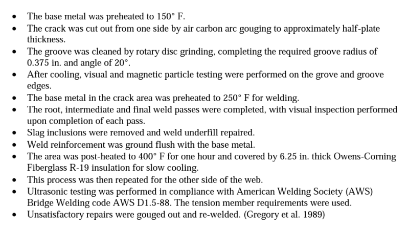

For cuts less than 1/8" I was thinking of following the cracks repair procedure outlined in "Welded Repair of Cracks in Steel Bridge Members (Gregory et al. 1989)", prep the cut as shown in the picture, and follow the procedure. However, I do not feel confident doing the same for deeper cuts.(where the cover plate is cut (40% to 100%))

Even with full depth cuts? will you still fill them with weld? Based on the photos, I thought the longitudinal cuts were shallow. If the longitudinal cuts are completely through the plate, my gut feeling is leave it but drill a 1" diameter hole at each end of the cut to get a nice stress distribution around the cut.
Would you recommend testing the steel although there has been some welding done to the bridge at one point? It's probably a good sign that the steel is weldable. I would take a look at the welds just to make sure there's no sign of cracking.
How do you feel about doing CJP for the transverse cuts?That was my thought CJP
