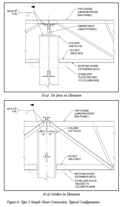

As to the stabilizer plate, the SJI specifically says don't weld it. Or perhaps more precisely, a former Canam Steel Joist design engineering manager shows a detail that says "do not weld", and mentions it is TYPICAL. (Yeah, it's showing a girder truss, but if you look, there's a plate coming at us for the joist that's on top of the girder truss coming in perpendicularly). I don't want these welded on anything I design (not that I have, lately, say 2017).

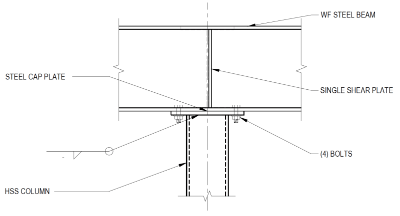

Current AISC guidance and manuals has a lot of discussion about stabilizing the beam web / column, the most straightforward is a stiffener at the beam bearing location. I don't think they show a "fitted" stiffener, but that's perhaps typical.
(Source: Steel Tube Institute)
This is "reasonably close" to the stiffener, Their post isn't really on this topic, it's just a decent visual depiction of the situation. The text does mention a vital need to stabilize the column out of plane....)

If anybody is interested in the background (further), May 2001 article from Modern Steel Construction.
New OSHA Erection Rules, How they Affect Engineers, Fabricators, Contractors, Barger, West, Modern Steel Construction, May 2001.
(images are a bit blurry, and it looks like they have a weld indicated between the truss bottom chord and the stabilizer plate). Maybe not, if I can find a copy of it in my garage I'll update. (Update, I don't think I have it, the main location issues start at June 2001), but if you read the text of the article it says you don't need to weld the bottom chord extension to the stabilizer plate.
