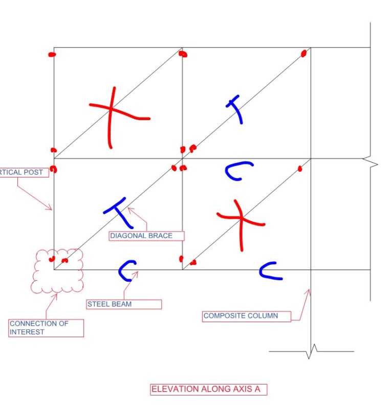

Hello guys.
Recently I have come across a cantilever space frame structure( please see the attached pdf before reading the rest of the post for better clarity). for clarity of details I have attached pdf file showing some portion of the structure. while most of the connections are standard type, the vertical post, bracing and floor beam connection detail at the edge( clearly shown in the attached pdf) is a bit complicated. the two beams meet at 90 degree angle and due to the presence of bracing and vertical post, the beams develop moment at the end ( it doesn't become zero as a typical cantilever beam). the presence of this moment together with the axial load from both the post and the bracing makes the connection design a bit challenging. could you please provide some insight on how to idealize and design a fitting connection type? sample would be much appreciated.
please note that the structure acts as space frame and the floor system is composite concrete steel.
 https://files.engineering.com/getfile.aspx?folder=e4355600-135f-4359-b2d2-65a1267e9c86&file=SPACE_FRAME_CANTILEVER.pdf

Hello kootk, I am delegated connection designer. Since most of the decision is already made, pushing for truss action would require them to go back and verify all the steps they did before.I don't think they would agree.

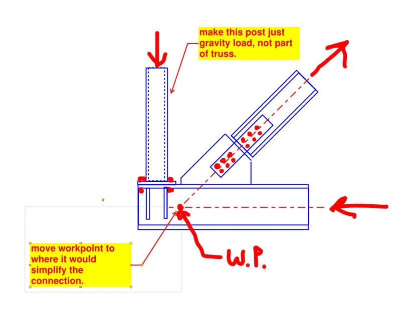

If you follow my recommendation below, the connection gets a whole lot simpler.
You don't need to push for truss action. Truss action will be the dominant behavior no matter what the EOR says. Loads follow stiffness and structures are notoriously bad listeners, particularly when they've been told stupid shit.

I don't even understand the logic in the trussing. I think this would work just fine and have half the bracing members and half the bracing connections. Maybe you want the bottom right brace for erection...

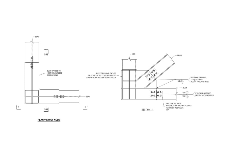

If you are forced to follow the original approach, I suspect that the way to go would would be to fabricate the entire joint in the shop as a 3-D super node. Then connect all of the incoming members with field moment splices. For that scheme, you'd be much better off with the post as wide flange rather than HSS so that you could get some flange plates on it.
If the post can't be switched to a wide flange, maybe you run the post through the joint continuously with some pass through horizontal stiffeners to reach out to the incoming beam flanges. You'd need three levels of these diaphragm stiffeners as one would probably need to hit the upper flange of the brace as well.

Could a node like this work for you? Sorry for the bad detailing, it's a busy day at the office.
