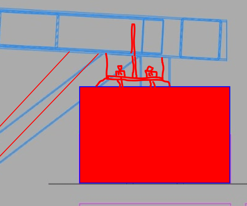

Hi all,
I want to discuss such type of connection where steel truss is welded to anchor plate installed on the top of concrete column. Steel truss is welded with fillet weld. It is considered that joint is rigid when truss post is welded around. My question is it possible to consider such joint as pinned or semi-rigid when welds are provided only on 2 sides?
If the bottom cord does not extend to the column face and if not connected , the truss essentially pin connected to the column. The stiffness of vertical truss element ( bbtw RC column and truss top chord ) is negligible when compared with truss stiffness.
If you need moment connection , it should be similar to the following sketch .
IMO, the moment conn. btw RC column and steel truss is not good a idea ..

@Jummybear: I don't love the overall connection setup. Are you in a position to modify it if you wish? Does the connection need to transfer wind/seismic/stability loads into the truss?
If you go with the original connection, I definitely would not go with the two-sided welds. That will not meaningfully encourage pin-ish behavior and will, instead, increase the likelihood that flexural stresses will rupture your two sided welds where they terminate in an unpleasant, fracture mechanics kind of way.

Even if the welds are not located on the correct sides for a moment connection (i.e. top/bot flange components), the welded sides will still be quite stiff which means you don't really attract that much less moment to the connection. As KootK mentioned all this will do is stress the extreme weld beyond capacity, which will then cause it to fracture thus increasing stress on remaining weld...and so on until it unzips.
If you think about a standard shear tab connection we specifically design the welds along the tab so that pretty much everything other than the welds will yield first. If something goes wrong in the connection we want it in the ductile components (e.g. the steel tab itself).
Is there anyway we can use CIP anchors instead of a CIP baseplate? The anchors can be sized/positioned to allow for enough rotation that it will be nominally pinned. And then we don't have any qualms with welding all the way around.

I'd prefer something that looks more like this, especially since wind load and stability demands on the column factor in. This is similar to how joist suppliers deal with these situations in the bearing seats of their trusses and you can trust that their solutions have been well vetted such that they represent sound practice. Even if you prefer to weld to an embed plate rather than anchor, I still like the proportions of something like this much better.

I was being completely sincere. I consider the details of a reputable supplier -- and their trade association -- to have been vetted via a process akin to evolution. Obviously, every detail has an appropriate range of application that needs to be respected.
In this situation, that tall bearing leg thing strikes me as altogether unwise for what is, essentially, a top chord bearing truss. It invites incidental moments, direct moments, and inherent stability problems. Raising the support closer to the bearing node of the truss alleviates all of that stuff and I assume that is, in part, why joist suppliers do that.

Discussing the connection of the HSS to the embedded plate in isolation, I consider the 2-sided weld to be rigid. It restricts end rotation just the same as if the HSS were welded all around. Consider a test case as shown in the sketch below. An HSS welded to an embedded plate in (2) ways. Option A is welded on the side walls only and Option B is welded all around. Under load, the deflected shape of each HSS would be essentially the same. The difference being the option with welds on two sides only would fail at a much lower load and likely more suddenly due to maximum stress being located at the termination of the welds.
I've seen this misconception on eng-tips and in practice often - just because you have removed rotational strength from a joint does not mean you have removed rotational stiffness. Stiffness attracts load and you better have strength to match. This is a perfect example. If welded two sides only, the welds restrict end rotation of the HSS and attract the associated bending moment that goes with that stiffness. The side welds are positioned poorly to transmit the rotational forces they have attracted.
The suggestion to assume a pinned condition may be appropriate and conservative for the design of some elements of this structure like the truss itself, but it would be unconservative to assume a pinned connection for the design of this welded joint and stub.
I agree with KootK's suggestion to extend the concrete column up and bolt the truss direct to the column. If you have to keep the HSS stub for some other reason I would try to bolt it down with a base plate and anchor rods. Field welds are expensive, especially when you have heavy equipment holding something in place while you weld it.

Rather than a fillet weld at the bottom, can you use a couple of clip angles so there is some rotational capacity provided by the legs of the angle?
The proportions and geometry of the joint will be changed, it was just a sketch from preliminary design. The main point I wanted to discuss was welding on 2 sides and how this may affect the joint itself.
Can you make a sketch? I didnt get your idea.
PS When using anchor bolts instead of welds what do you suggest for bearing between steel and concrete: steel, neoprene pad or concrete grouting?
