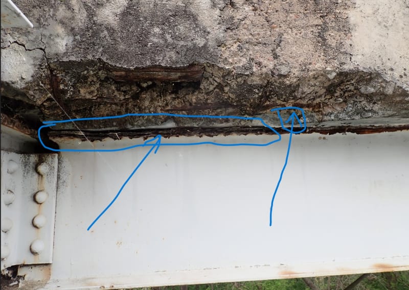

Hi everyone,
I would like to get some opinion / inputs on a detail that I have put together for stringer repair on a Truss - Floor beam - Stringer system bridge.
A little background info on the bridge - Very Old Steel Truss bridge, Ard 1910's. Currently closed to traffic and, the repair design is just to serve as a ped bridge. Bridge is in very bad shape (truss elements and gussets deteriorated). The deck on the truss spans (3 spans) will be replaced to meet current standards.
Stringer Deterioration and Repair Info - The top flange of stringers (both fascia stringers) exhibit severe corrosion, lamellar rust and section loss with separation from deck interface clearly visible on some. Since the bridge is very old, kind of trying to avoid welded details as multiple sources say to avoid welded details on very old steel structures, and also from a point of view of trying to make it a better fatigue detail.
So was hoping for inputs / criticism / suggestions on the drawing.
Thank you everyone. Eager to hear responses.
There wasn't any sketch attached. Anyway, on the left side of the photo, is the flanged gone? My suggestion, since you're replacing the deck, replace the deteriorated stringer(s.) Flanges are a messy repair when there isn't any meat left. Post your sketch and I'll take a look.
Hi BridgeBuster,
Yes, that's correct. The location you marked is the area of complete separation of the top flange (lamellar rust) with the deck interface. And, given how the bridge is just going to be a pedestrian bridge, the clients preference is to repair rather than replace. here, is the missing link to the repair detail.
I appreciate your help and time in replying to my questions. Thanks.

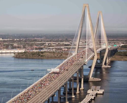

Revisit that assumption with calculations. Perform the calcs BridgeSmith recommended. If you use a widely accepted pedestrian bridge live load of 90 PSF, there is a good chance the structure will fail... and do so by a wide margin.
Don't LOL that the odds of that load happening are "impossible". Cities sometime offer large scale public events... like the Cooper Bridge Run & Walk in Charleston, SC (a small city). Every spring 40,000, or so, people run / walk across the modern cable-stayed bridge over the harbor:
The bridge design was based, in part, on that pedestrian loading.

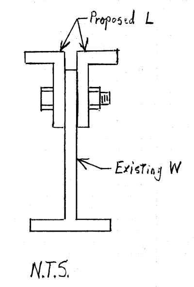

Concerning your proposed repair detail... a nice start. However the repair is not symmetric about the Y-axis... not good. Use a pair of angles bolted to the web to maintain Y-axis symmetry. When plate girders were fabricated with rivets, that was the "standard" way to address this issue. Also, do the calcs to determine bolt spacing... I expect you have far to many in the detail. Modifying and installing those bolts is expensive, labor-intensive work.

ELNW - IMHO, Creating a slip critical connection in the field, on deteriorated 110+ year old steel is overly optimistic. I suggest trying to avoid relying on slip critical.
Looks like the existing WF is most likely a 1907 Bethlehem B15 (I = 465 in4, S = 62.0 in3... when new). The new T section appears to me to be way oversized (probably not "bad", but a waste of money). Is there a standard WT section (shop fabricated from a W section) that could be used instead?
I totally disagree with your supervisor's overruling your double angle proposal... but that is out of your control.
