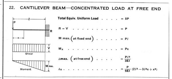

Using first principles, calculating the upper bound of moment and shear of the post is straight forward:
1) Go to the "Beam Diagrams and Formulas" section of any edition of the AISC Manual of Steel Construction.
2) Assume the concrete is fixed and rigid. The post is cantilevered out of this concrete.
3) Select the loading you want to evaluate (four loadings are given for cantilever, others can be approximated from these four).
4) Do the calcs.
For example, here is the diagram/equations for "cantilever beam - concentrated load at free end" (that is, load applied at top of the post).
It's probably conservative to just ignore the concrete for this check. You'll have your post embedment with some triangular distribution in the soil. You'll also have a load applied to the post. From that you can make a bending moment diagram and shear diagram by which to design your post. More than likely it'll end up close enough to SRE's suggestion that his would be just fine.
