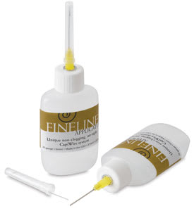

You can buy a Fineline Precision Applicator at an Art Supply store. Link

Trying to rebond the rubber is likely to just leave an ugly mess.
