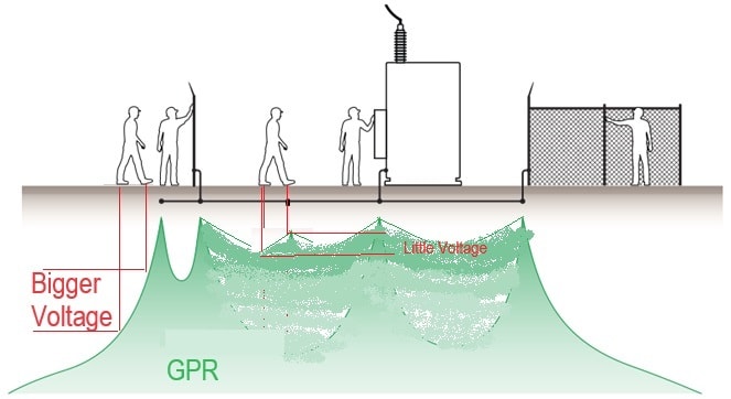

Typically your maximum step voltages occur right at the edge of the ground grid, think of the GPR as a plateau and if one foot is on the fence ground loop and the other is off the 'cliff' that is a big step potential.

As Jghrist mentioned, you can increase the mesh outside the property line, (you can see the person walking on the edge is near the 'drop off' of the GPR, while within the substation you can add another conductor to make the soil voltage closer to the GPR of the ground grid.

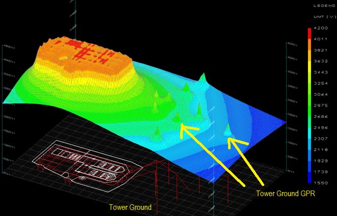

But the lines themselves extend neutral conductors outside the substation and are connected to ground wires running down poles that are exposed to the public. Does this cause a transfer potential problem?
yes, in North America and other regions we use a multi-grounded neutral for distribution, and many areas have shield wires providing a metallic connection from the substation grid to the tower grounds. With that metallic connection you would see a transferred voltage that exposes the public to shock hazard (I made more graphs with paint to annotate)
In Australia they seem to consider a risk based method to evaluate if tower/pole grounds should have an analysis like we do for substations. I believe it is common to study tower's that are joint use with telecom as well... but I think there is more work to determine the risks and where to do detailed studies for mitigating hazards. In the substation's we know we have personnel performing maintenance so its industry standard to design an engineered system to protect from touch/step.
